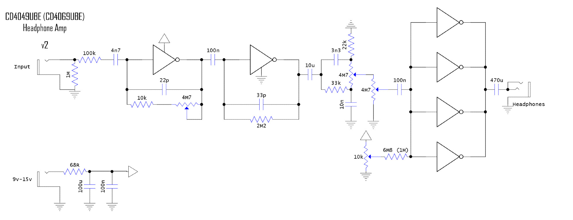

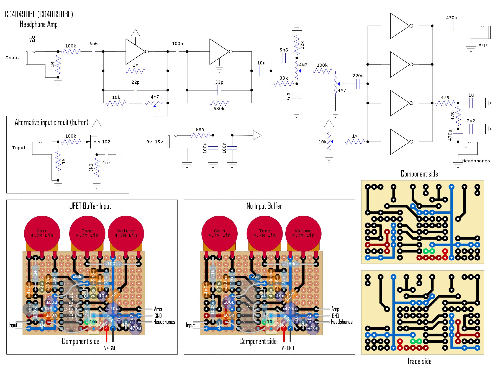

I was initially using headphone amps to drive the amp, and they work great, but I fear they'll break in case of a bump or fall.
Which is also why I don't think I'll use tubes, but I do have a good selection of them (I'd be here for a couple days listing them, but basically I have 7-pin, 8-pin, 9-pin, subminiature and "pencil/rod" submini tubes, to give you an idea).
I also have like a dozen or so J201s. In fact, I stayed up late trying to finish a Runoffgroove Eighteen on my protoboard to test, but had to stop mid way cus I was falling asleep doing it haha.

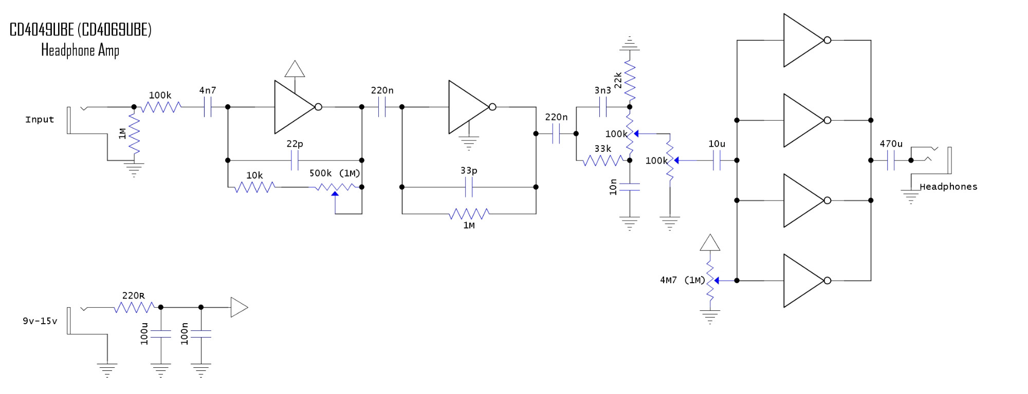

I just found out I can get symmetrical +/- voltages from those cheap DC-DC buck converter boards:
I'm gonna try this when I get home, because I fried one of my ICL7660 trying the circuit yesterday (max V+ for them is 12v and my PSU is delivering a tad bit more than that).
Also, I redrew the Bass 12 schematic and marked the different component values with the Lead 12, so when I eventually make a layout, I'll do it so you can build either one of them in the same board.
She/they since August 2021
blackcorvo
Quote from: blackcorvo on July 03, 2025, 07:01:22 PMI just found out I can get symmetrical +/- voltages from those cheap DC-DC buck converter boards(...)
Update: it works! The negative side is not perfectly symmetrical with the diodes I have on hand (they drop a couple volts in comparison to the positive side), but it works.
Doesn't seem to have the same level of distortion from what I've seen on videos online, but it might be just that on those, the power stage is being pushed and overdriven.
In my case, it pushes it to the point I think some kind of overload protection kicks in and mutes it (I tried powering the PA from the positive side of my XL6009 buck converter board to see if the higher voltage stopped that muting issue, and while it reduces it, it's still happening on volume settings beyond like 50% at full gain).
Might need to add a limiter stage between preamp and PA or something like that.

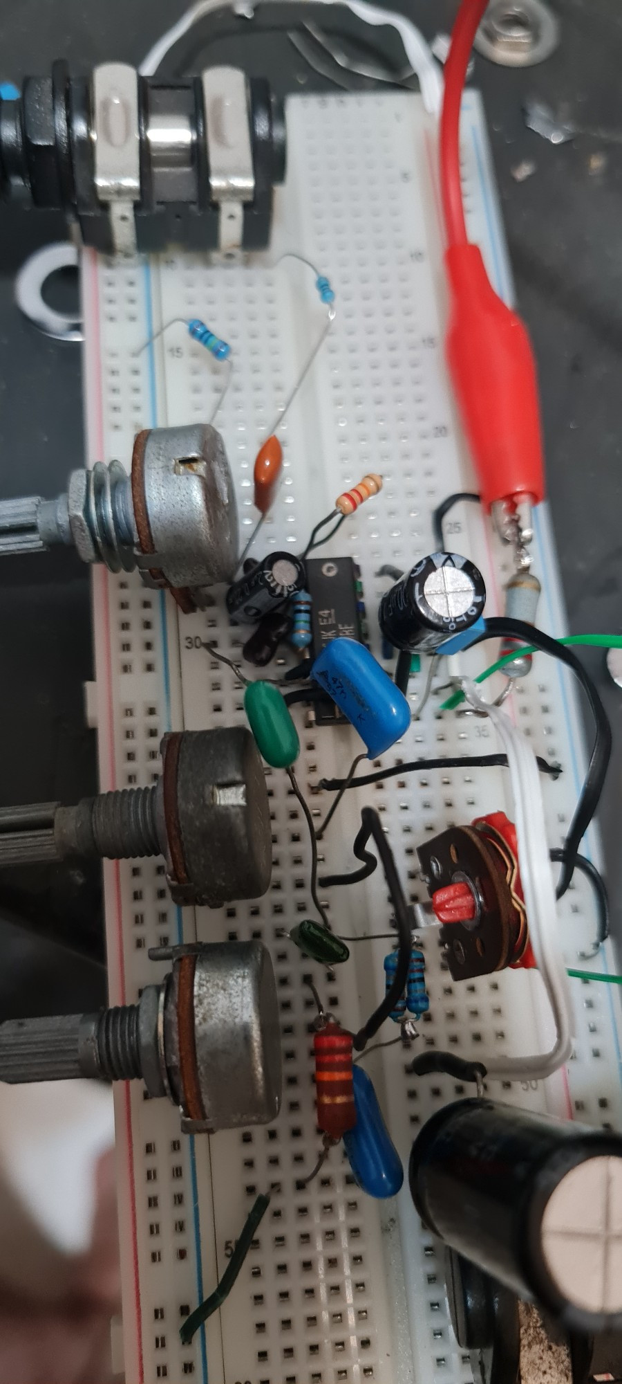

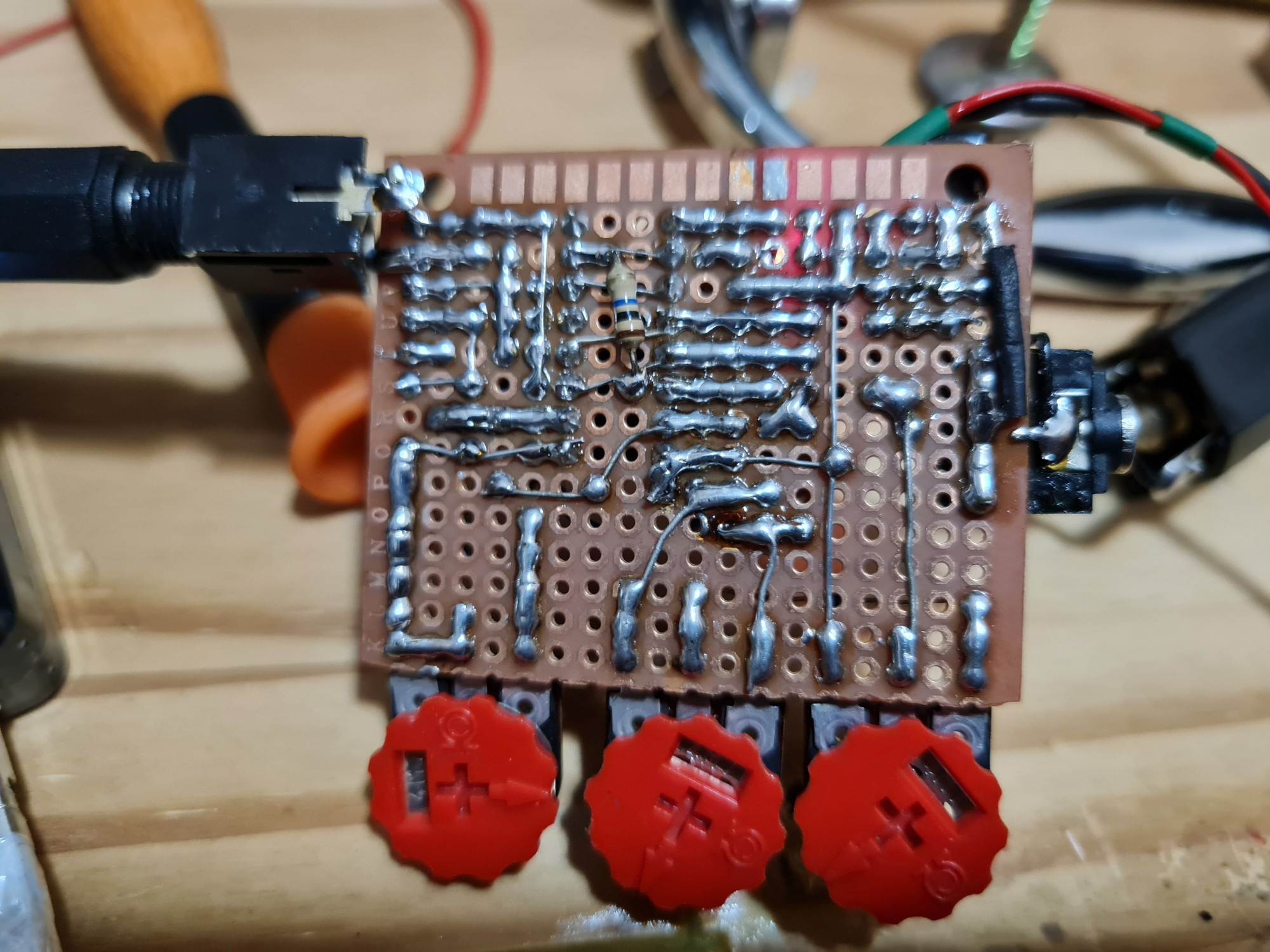

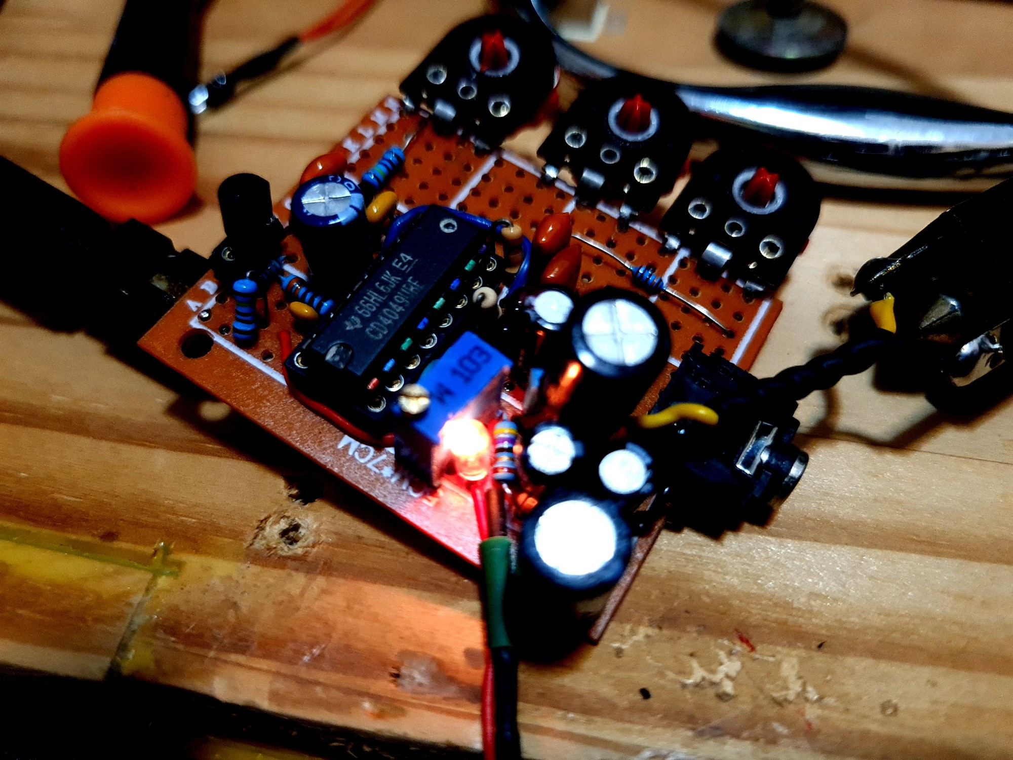

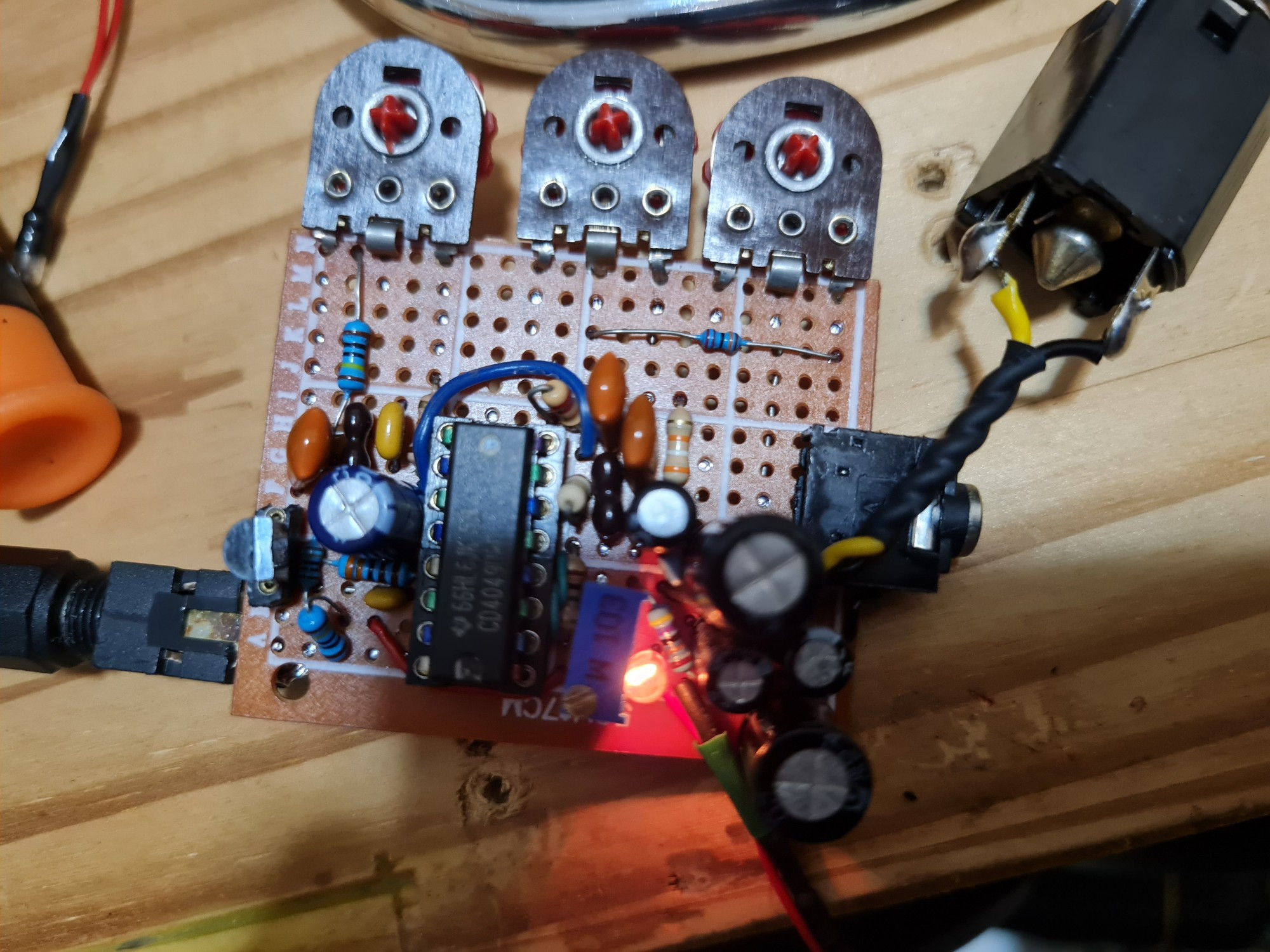

Also a bit of an update.
I had ordered a couple battery holders and they arrived yesterday. I drilled a hole in each to run the wires under them into the speaker box, and installed an LED on the original holes for the wires as an indicator for that pack being on.
Potentiometers and jacks for the build will probably arrive by the time I'm back home from work today.
I also did a layout. Yes, I cheated a bit by looking up pics of the original amp boards, but I changed a few things around to try accomodating it in a more compact build. Lastly, I show the changes needed to turn the same layout into the Lead 12 in red on the board.

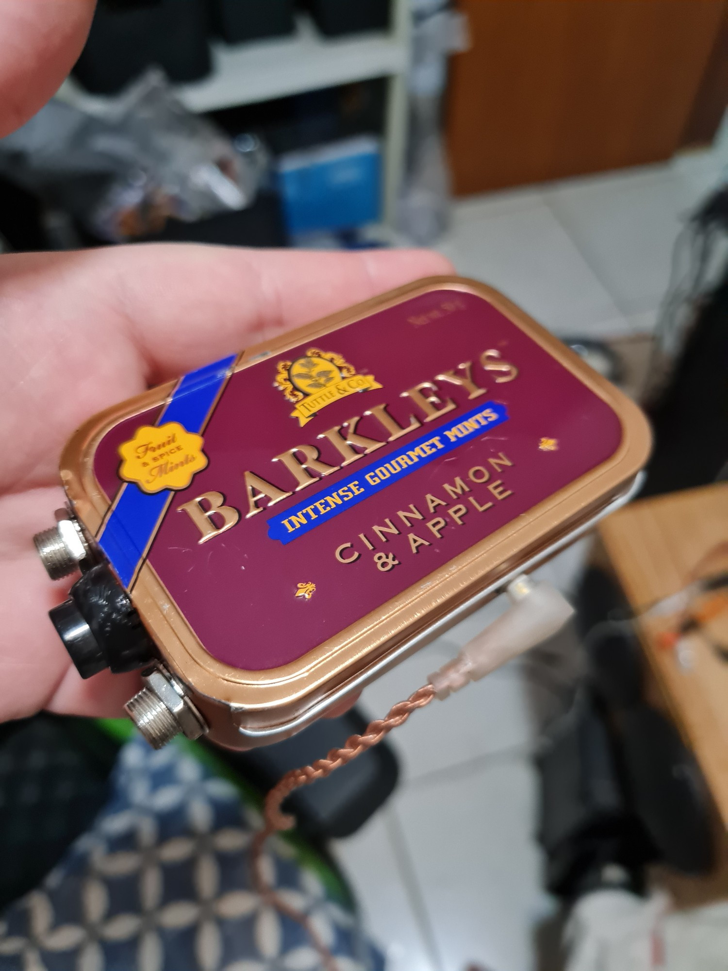

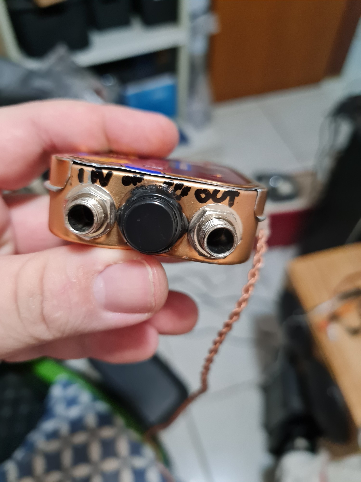

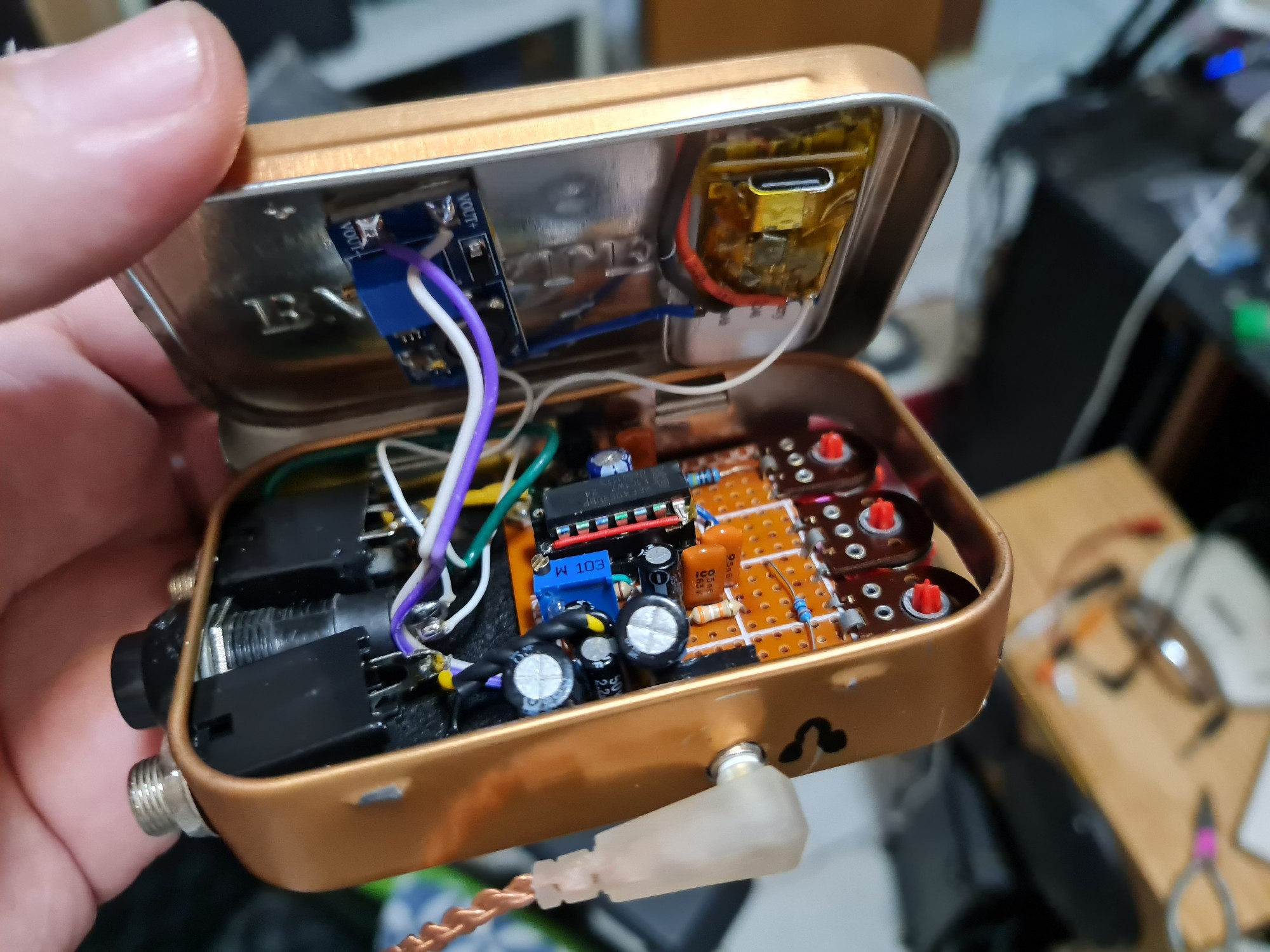

blackcorvo

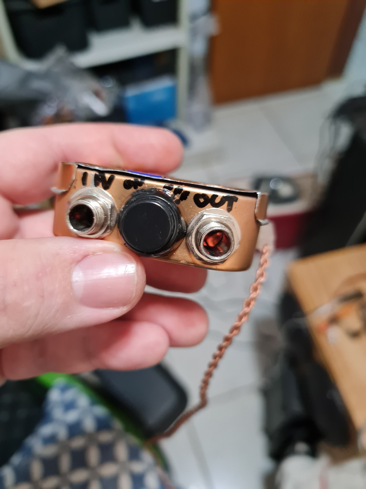

More pics of the build.
Drilled some holes, routed and soldered some wires, now I'm wainting on another order of 1M Log pots (weirdly weren't available before today) and knobs, coming tomorrow.
The extra jacks are for using the P.A. with my headphone amps (Vox AP2-AC, Joyo JA-03B, Xvive GA-3). They plug on the top P10 jack, Phones out goes into the 3.5mm jack next to it, guitar cable goes on the jack on the back of the cab.
When these are unplugged, they connect back to the internal preamp.
Another thing I wanna do is add a power jack, and also have the original speaker contacts be a utility power out for pedals and such. Curently, it's the power input.
Lastly, I wanna see if this "passive compressor" on the last pic could help with the P.A. input overload. I'll put it on the protoboard and see how it does.
blackcorvo
Getting a bit further.
Tomorrow I'll test the "compressor" circuit to see what it does to the signal.
blackcorvo
Here's a video update showing the passive compressor working, and a second solution I came up with that I feel works better and is simpler.
The simpler solution is an AGC circuit:
But with the clipper using 2 LEDs instead of an LED and a diode, and only a series 100R resistor, no capacitor.
Next I wanna try a rectifier with the LED in the middle (like the diode clipper in a JCM900) and see how that does, reason being that in the 2 LEDs clipper, the LEDs are only on for the half of the signal each clips, while with a rectifier the LED will clip both sides of the signal.
[Edit]
Attachments added for the tone stack curves with the switch at different settings, and the project layout.
Also of note, I changed the capacitor to be wired like a typical Marshall mid control instead of how it originally was (morelike a Fender), which makes it so turning all tone knobs down doesn't cut the signal completely, and gives IMO better isolated control over the mids.
