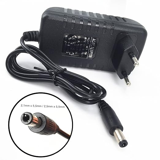

dazz
Quote from: Katoda on January 30, 2018, 09:37:59 AM
Awesome, now that you know the source of the hum, you can take measures to eliminate it. It might be as simple as opening the hard drive PSU and connecting the chassis to the output ground, or as annoying as having to buy/build another PSU, if the current doesn't even have a 3-pronged mains cable.
If you are feeling adventurous, you could open the hard drive PSU, desolder the current 2-prong cable and replace it with a 3-pronged one, connecting the mains earth to the output ground (be careful if you do that, small mistake could mean a large fire and/or electrocution!!!)
Unfortunately it's one of those without a prong: the plug is integrated in the whole thing like this one:
What if I take it apart and mount the inner circuit inside my chassis with a mains ground connection? let's see what's inside....

Katoda
Crap, i was hoping there would be a cable... I wouldn't recommend mounting it inside the chassis, the coils would probably radiate too much for such a small enclosure. If the smps circuit has a transformer (as in - not just an inductor), you could fit in in another enclosure, one that would provide a connection to earth, but that's quite an advanced challenge, because you're dealing with potentially lethal voltages there.
If it's just a buck converter, there's nothing you can do but to buy another PSU. No mains isolation is a no-no.
Yes, the earth should be connected to the negative terminal, the ground.

Umm, not sure if what I did is safe then:
So I ripped the power supply, wired the hole thing with one lead from DC(-) to ground, wrapped the PSU in duct tape and mounted it like that. It works great but is that thing safe?
