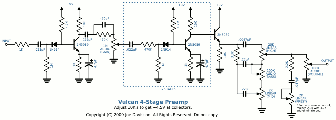

dazz
Thank you Steve, of course that helps, a lot
I've been googling for preamps and found this one, but that Vibin looks much simpler.
I plan to use vero-boards. We'll see if I can pull this off

Actually Dazz that one looks pretty good. Geussing you could put in 10k pots to adjust bias to 4.5v or use your ear..then measure and swap out for single resistor when circuit is stable. I think i might breadboard this one up. cheers for the tip
dazz
The section labeled "3x stages" is supposed to be replicated 3 times in series, right?

dogbox
Quote from: dazz on January 10, 2018, 12:36:28 PM
Yeh.. http://www.diystompboxes.com/analogalchemy/   theres a link to the original vulcan pedal...it's basically 3x stages of that which he inserted. The cool thing is you could try 1/2/or 3 stages..see whats needed. you could also insert a a jfet version of the vulcan in there, or pretty much whatever you want, for a distortion channel.
