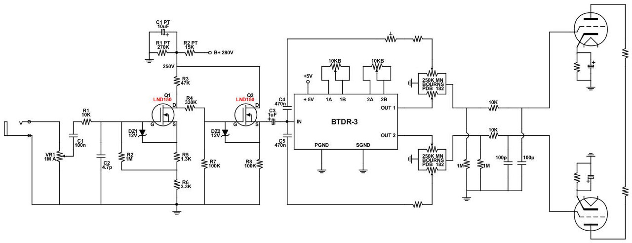

Hi, my name is Franco
I'm a class of 1953 tube enthusiast, known as Kagliostro at DIYItalia, EL34World, AmpGarage, and aggh.net

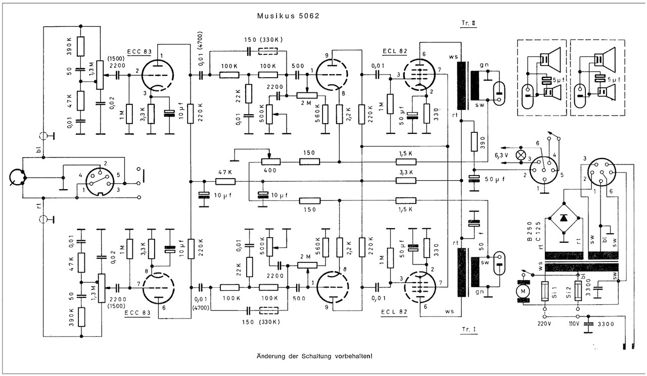

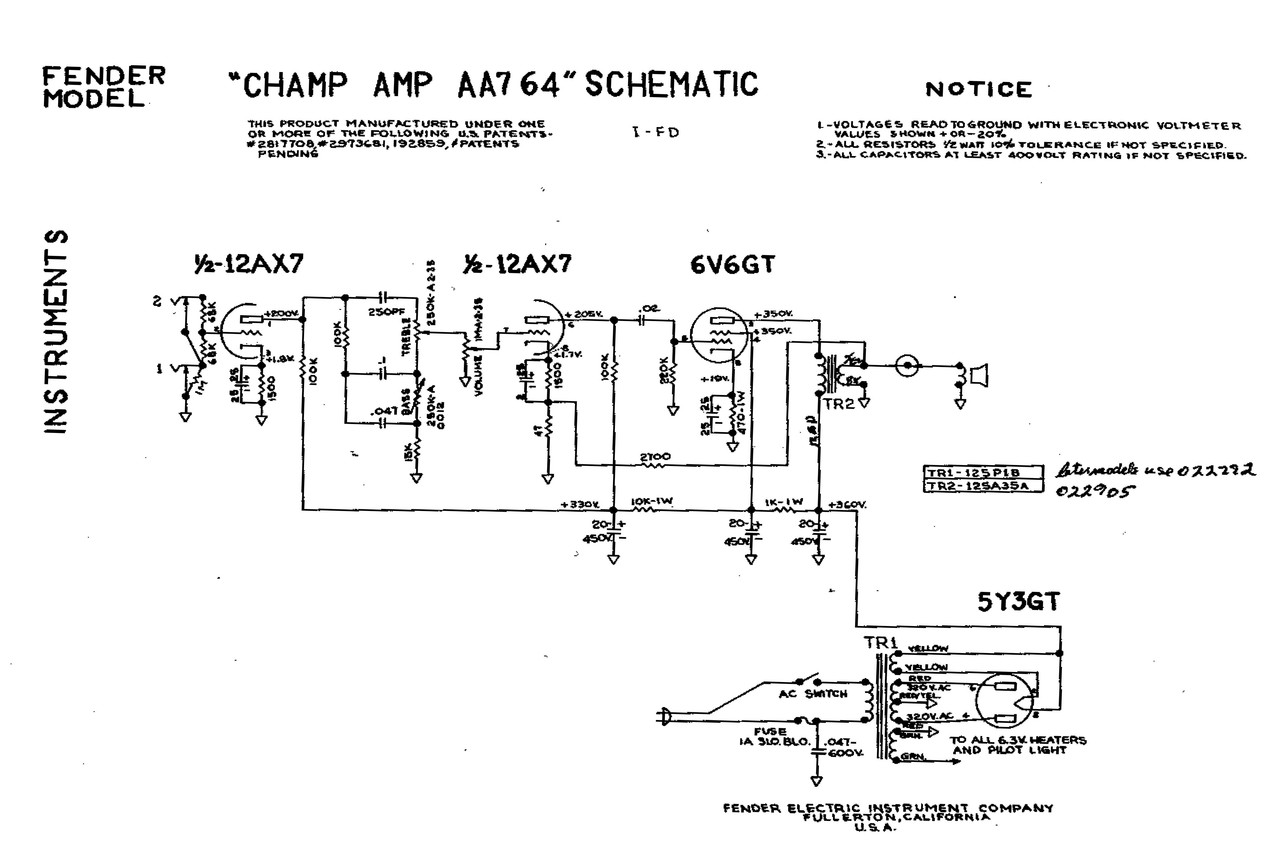

I have a Telefunken Musikus 5062 Stereo Suitcase Turntable (2 x 4W) that I want to convert into a small guitar amp (EDIT: 2 x Fender AA764 circuits)

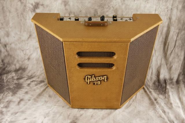

As it's a stereo build, I'm thinking of using a V-front cabinet inspired by the Gibson GA-79RVT to help widen the stereo field
To further expand the sense of space, I decided to use a Belton BTDR-3 reverb module (Mono IN - Stereo OUT)
http://accubell.eparthosting.co.kr/upload/product/file0_1650341049.pdf

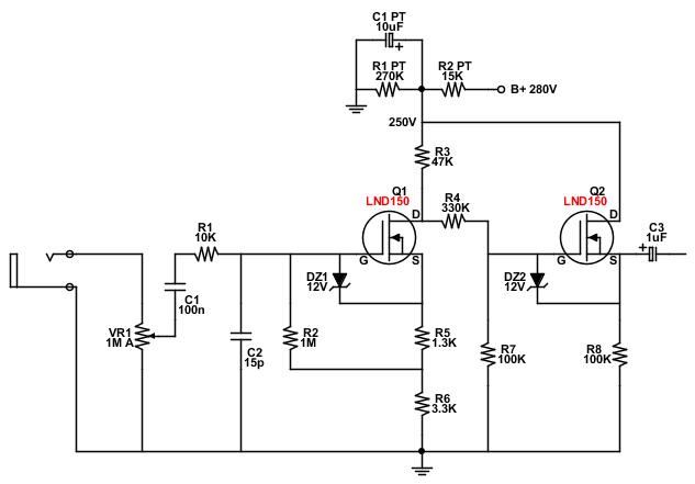

However, at the input I had to insert a buffer stage to ensure proper impedance matching and to attenuate the signal level so as not to overdrive the Belton module (BTDR-3 Spec. Z IN = 10K - Max 1.5V - Z OUT = 220R - OUT -3 db)
While I understand something in tube circuit, solid-state designs are definitely not my suit!
With some effort and external help, I put together this LND150 buffer stage
Z IN = ~700K - Z OUT = ~650R - Gain on Q1 = 8.9x - Gain at the OUT = 1.87x
Please let me know if you notice any flaws or incorrect component values in my approach, or if it all seems completely wrong to you!
