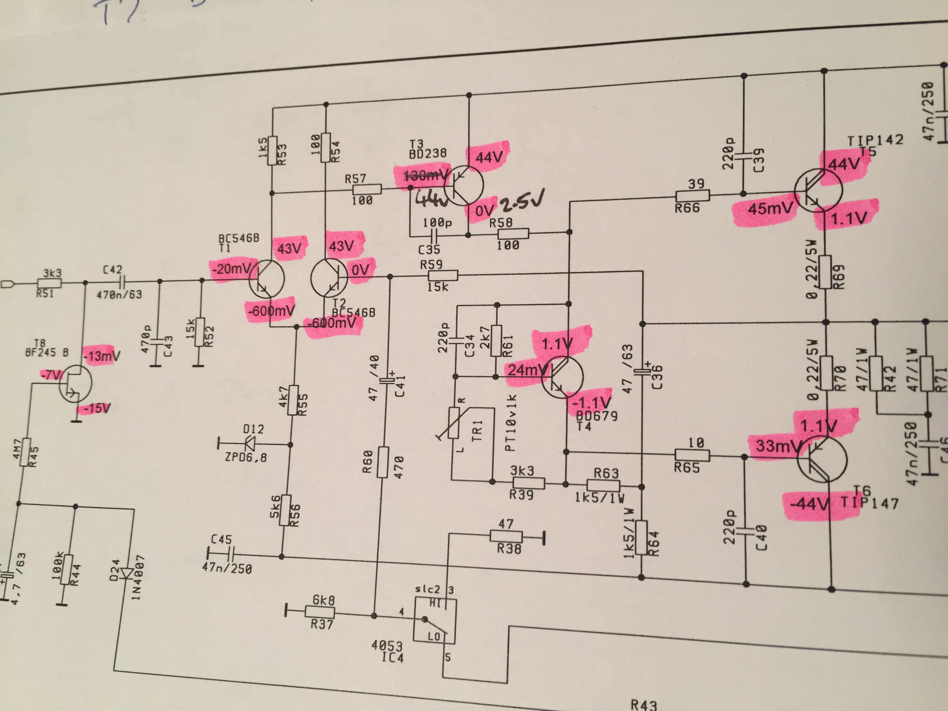

That voltage was indeed a bit weird. I've not got confused with the BCE pinout but the voltages are different than I measured the other day.
T3 Base is 44v, Collector at 44v and Emitter at 2.5v
Not sure why that happened unless I hadn't grounded the meter lead properly or the probe was not touching the solder.
Doesn't help though really does it I guess?

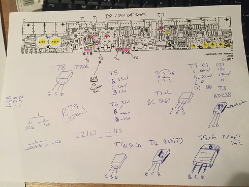

This is how it stands now.

Excellent, we can use those numbers later.
For now, most of those DC voltages look good except T3.  Can you measure from E to B (one probe on each leg).  We are looking for about 0.6V difference between the two.
Please also recheck T5 and T6 voltages, I think B & E are mixed up, and T6 should be -1.1V, not +.

I rechecked the voltages around T3 and there must have been an issue with me not connecting correctly. The Collector was 2.5v with Base and Emitter both at 44 v
g1, I measure the voltages on T3 Emitter-Base whilst the amp was on and it was about right, at 0.530v.
I did the diode check on the DMM on T3 too to see if that identified anything, there was an oddity in the Collector to Emitter of 1.75v (whilst amp was switched OFF)

I also rechecked T5 and T6, traced the circuit to make sure I was right on the E,C and B.
The measurements with the amp on are consistent with the above post apart from the  emitter on T6 should have been -1.1v (you're spot on), with the amp off E>B drop of each is 1.1v

I'm sorry but I'm getting confused as to what readings are amp on, which are amp off, and whether the diode checks are with transistor in or out of circuit.
The leads of T3 are E,C,B (left to right) looking at the printed face.
If there is .53V from B to E running, then one should be around 44V and the other around 43.5V
Please check again the exact DC voltage for the three terminals of T3 with amp running.

Phil:  Agree that it is probably some bad connection bursting through when sufficient signal is applied.  But, first I wanted to be very sure it was not that T3 is turned off and is only turning on when big signal applied to it.  Seeing 44V listed for both base and emitter, I'd like to know the exact voltages there.  The .53V 'across' was listed for both power on and off conditions, so I was confused about which it was and would still like to see the exact numbers with power on.

I've rechecked voltages on T3 with amp on and no input, double and triple checked pinouts.
T3 Emitter > Base was 511mv (.511v)
E>C was 41.3v
C>B was 40.9v
This sounds like the T3 was behaving normally.
T2 Base = 0.006v, Collector 44v, Emitter -600mv

The pinouts I've been working from have been scavenged from the web and are as follows:
Thanks again.
