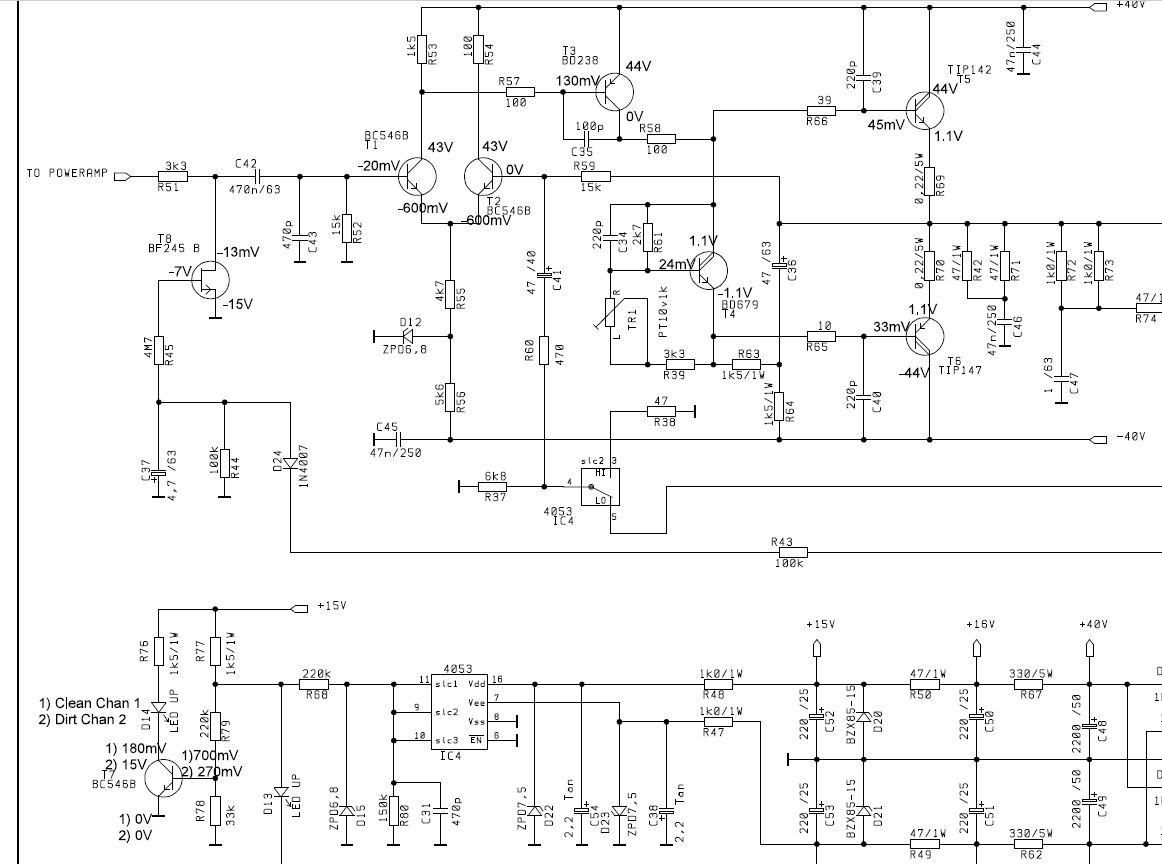

I'm not sure what else it can be, almost every other component in the Poweramp section has been taken out and tested or tested in place. I'e also attached a photo of the circuit that I've been using to identify stuff and everything highlighted has been tested to the best of my ability.
Thanks for your help.
Bob
Well, there are only 6 transistors in the actual power amp section, so how about some static DC voltage checks (no signal applied).
Base, collector, emitter, for T1 thru T6.
batbob
g1, static DC voltage checks, not sure if it's what you meant but I switched on the amp with nothing in the input and measured DC voltage at each base, collector and emitter to ground.
The results are attached in the PDF with the voltages written next to each leg of the transistor.
I've stuck the img in here too to save opening up the pdf.
Thanks again, Bob

There is something seriously amiss with T3's voltages.
You have 44Vdc on one side of R53 (1K) and 43Vdc on the other.
That is to be expected.
But 43Vdc through R57 (100) seems amiss at 130Mvs.
I would check R57 and T3.

Thanks Jazz. I'll double check it after work to make sure I've not got my pin outs wrong. I was working on the underside of the board and getting confused as to which was e,c or b. I think I got it right but will double check.
The resistor I've had out of circuit and it read ok but I'll chexk it again too.
