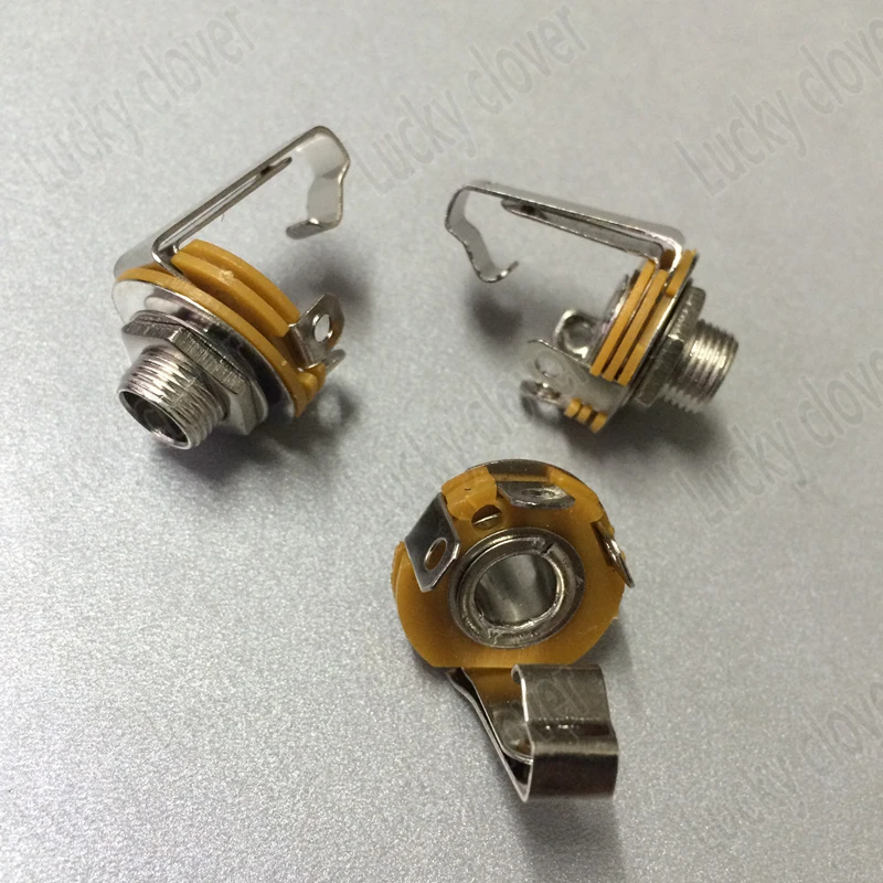

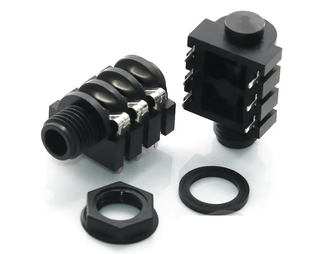

First hurdle in my build: the TDA7297 is bridged so the outputs aren't grounded. I'm building the amp in a cannibalized computer PSU chassis, so the speaker OUT sockets look like these:
Of course those sockets ground the speakers when mounted on a metal chassis like mine. I think I'm lucky I didn't blow up the chip, ugh!
ANy ideas on how to isolate the speakers connections please?
blackcorvo
If you don't mind waiting, there are isolation washers you could try using for this:
https://www.tubedepot.com/products/isolation-washers-for-1-4-input-jack-flat-shoulder
If you'd rather not wait, or youc can't get that kind of washer, you could cut out a square in the chassis and use a plastic panel to mount the speaker-out jack to it. Or maybe a wooden panel, whatever fits the style of your build better.

dazz
#24
Quote from: blackcorvo on January 28, 2018, 08:02:29 PM
Thank you, great stuff. Those washers look exactly like what I need. Problem is I'm in Europe and the $14 shipping fee is too much for such an inexpensive item, I'll see if I can find those somewhere else. If I can't I'll probably use a wooden panel
ETA: I think these connectors might work
Katoda
Yes, just buy those plastic jacks, they are way more reliable anyway, IMHO.
Check out musikding, they have low shipping rates for small orders.
blackcorvo
I agree with Katoda, the plastic jacks are pretty good!
She/they since August 2021
dazz
Thanks guys. They're dirt cheap too! Just ordered a bunch of them off of ebay for a couple €.
