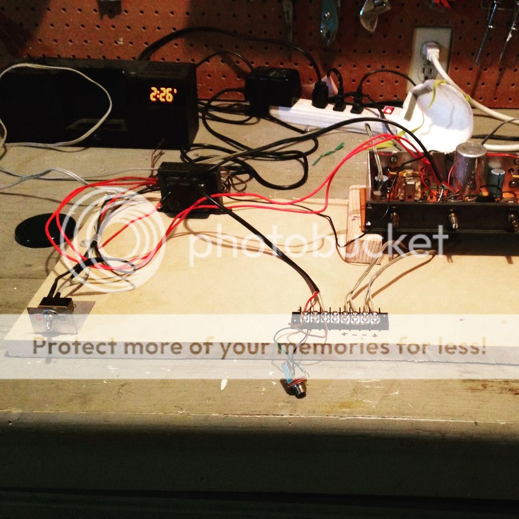

I've got an annoying problem while turning/adjusting the volume on ANY instrument!... or volume pedal... or acoustic pickup with a volume....etc,. Looks like a classic sign of a dirty/worn volume pot on the instrument etc,.OR a bad cord...but not so. It all started when I successfully cleaned the Master Volume pot and all others on my 1991 Tube Works RT-2100 MosValve+Real Tube OverDrive 100 watt Combo Amp. Concept and Design by B.K. Butler. I used a can of Deoxit Gold G5 spray. It worked GREAT! Noisy Crack POT SOLVED!! But not so fast grasshopper...Now it's developed this annoying glitch while adjusting ANY volume going in to the input ...either channel. I  have switched the Master Volume pot out of the amp...no diff. Cleaned guitar pots...changed cords...different power outlets...tried ANYTHING with a volume...to no avail. Still got the problem. What could be taking the input signal and making noise ONLY when it is being adjusted with a volume pot? Any suggestion? I have soldering skills and can work a multimeter. By the way...the amp works perfectly normal on both channels. All amp pots are clean and no noise.

Correct. Straight into the amp. On my multimeter ( which I've included a pic of ) I have a reading of 13.70 DCV at startup and slowly climbs to 13.99 DCV in approx 5mins.

I have other input jacks I can try out on the input board by just soldering the replacement jack to the input board in a way that it bypasses original jack and still uses the resistors ( which I have checked out and are fine ) but like Fahey says the schematic seems to be wrong? Here's what I have, 3 wires,... Red (I) Black (G) Purple (CA). 1st what does Purple (CA) represent?

Hurray!!! I removed the channel 1 input jack from the input PCB. Installed a two wire input jack on the input PCB to the Tip/Red (I) and Sleeve/Black (G). All voltage is gone at instrument cord and PROBLEM SOLVED!!! So.....what did I just eliminate? I can't for the life of me see anything wrong with the 5 point input jack that I just removed. Here is the Amplifiers input jack features posted in the users manual:
