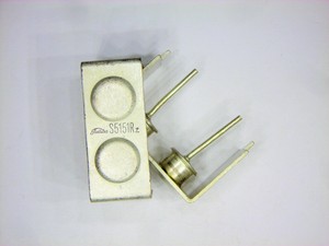

Still wasn't getting any readings on the odd-looking silver diode apparatus (S5151R), so I tried measuring the parts on the under side of the shield. I touched my DMM probe to one of the poles on it, saw a spark, and then the amp shut off completely.  The primary fuse blew, the others on the DC board are fine.  I don't have a 250v 3a fuse at the moment so that's all for tonight- any idea why I couldn't read voltages anywhere on that diode and then when I touch the underside it sparks?  It did read over 100v when the spark hit, but then everything went out.
Here's a pic of the diode thing for reference:
I had hoped we were working on restoring the 15v supplies.  Have we moved on to other things?  Those dual diodes are shown in the schematic as part of the main supply to the power amp.  Not part of the 15v circuits.
The dual diodes are each half of a bridge rectifier, D207 and D208.  The dual diode 5151R has common anodes, and if you look at the schematic, that common of that pair is connected to ground.  The frame of it is the common terminal.  The two pins underneath connect to the two red HV AC wires from the transsformer.  So ther would be AC between them, and a meaningless measurement to ground from each.  You probably saw 100v because that is probably roughly what the supply voltage it is making might be.
Please go back to fixing the 15v supplies unless they have already been corrected.
