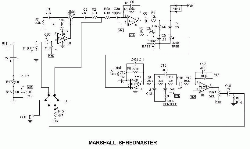

My friend said Little Rebel's tone control is too subtle. Can anyone explain what topology it is and suggest modifications? I just can't figure it out with my limited knowledge. xP
Having read Temuuk's book (great job Temuuk!), I am trying to change the tone control to active FMV. I also use the remaining op-amp as active low pass filter to cut high freqs. This IS my first attempt in modifying / designing an amp. Please point out any mistakes as I tend to copy & paste schematic fragments and glue them altogether. :duh

"Subtle" eh.  And unique too - don't recall ever seeing anything quite like that before; all their own work I'd say.
As you can see the treble and middle come before the master volume, and the bass control after, so a simple conversion to some from of Fender/Marshall/Vox type passive isn't really practical.
In fact given how little there is in it you may be better off building something similar from the ground up using the tonestack you want.
What you could try playing around with is making the existing controls a bit less subtle.  You can't model this in Duncan's Tone Stack Calculator since it isn't any of the common arrangements, but you could model it in LTSpice or Tina-TI (both free).
Really, the question you have to answer first is "what do you want?", more bass, more treble, more control range?  Then we can have a look at which components to change in value that might give you what you want.

It's not subtle at all, and it's not your typical FM tonestack either.
It's a tone control specially developed by Marshall for their distortion pedals and attending their particular needs.
The Little Rebel designer didn't actually do much "design" , if any, just copied and pasted.
It's basically a ripoff of the Marshall "Guv'nor" family pedals,
with a bass boost added (since it will typically drive very small speakers) , straight driving a flat LM386 amp.
A FMV tone stack will probably sound buzzy (that's why the other one was developed).
So if you find it "dull" .... well, it's its character.
If you want to homebuild an amp, go for, say, a Valvestate 10.
KILLER little amp
And same complexity or simpler than the Little Rebel

I have compared the two, and indeed they are identical from input to clipping diodes. But I'm still confused about the bass control. I haven't seen anything similar to it. Can you give me some more explanation about it? So I can learn more about these things. <3)

1) that strange "dull" Marshall tone control was developed because distortion pedals are meant to be used before a guitar amp, which typically has gobs of treble,
Buzzy means not only highs (which are fine) but "ugly" highs.
The same sound as putting a piece of paper on a hair comb and blowing into it to imitate a harmonica/trumpet/sax, o what you hear of a mosquito flying at night when you are trying to sleep or what has been described as "angry bees inside a tin can" or more graphically as "icepicks in your ear".
As you see, all "ugly" sounds.
Now, if you send that distortion pedal straight into a flat power amp , which has *no* treble boost, the same design sounds dull and *appears* to have poor range.
Mind you, that same pedal into a Marshall amp is killer!!!
This is another, more "normal" version of the same family, the Shredmaster.
It has a more normal looking tone stack ... until you see the values have been totally edited, in a gross way.
The bass net, 68K/.022 is now 6K8/.022 so it has shifted up 10X !!!!
TONS of low mids (to add "body")
And the treble net, 500pF/220K now is .022/22K (shifted down 4X) to provide mid/high mids instead of highs, to avoid emphasizing "buzz".
So as you see, pedals are good used as intended, but not so good as preamps, because the requirements are different.

Btw Fahey, when I looked at Little Rebel and Guvnor, I realized that they're virtually identical. The difference is that in Little Rebel the bass control is made "fixed" with 1k5 and 100k resistors, and it uses (as you mentioned) a variable bass boost instead. :o
So here's my mod:
  • Replace 1k5 and 100k resistors with a 100k pot and use it as bass control.
  • Replace the 1M bass pot with a jumper. Or better yet, rename it to "depth" or "bottom" control, I think it's more appropriate. But my front panel is too small and crowded, so I just jumper it.
Viola... The tone control now have better and more "normal" freq response, especially bass freqs. :dbtu: <3)
