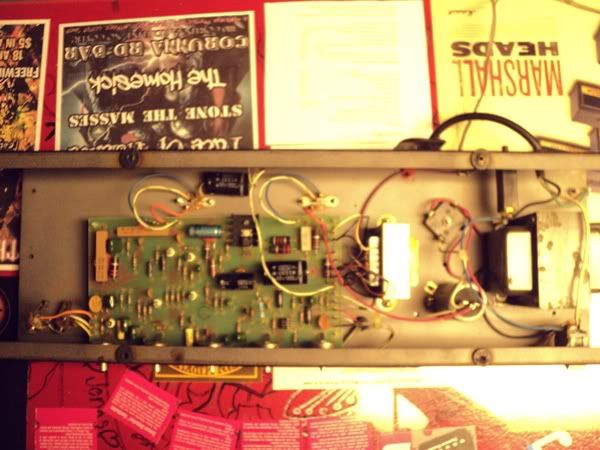

Picked up a Sunn stage lead for next to nothing. Has power but no sound. Found an open 680K resistor which I replaced. When I powered it up it fried one of the power resistors on the board. I couldn't find a schematic for it anywhere so anyone had any luck with these?

2) from what´s visible in your slanted picture, the power amp has a driver transformer.
Please take a new one "from above" to see the entire board and how many power transistors it has, to compare it to better known models.
*Maybe* the power amp matches something .
Also show a closeup of the burnt area.

Best pic I have at the moment, top right corner of the board just left of a ceramic resistor are two brown resistors. The one on the bottom of the two went up in smoke. Thanks for the schematic, looks similiar.

The burned out guy is a 33 ohm 10%, is it safe to say a 5W will be sufficient?
No, because *someting else* is burnt.
First repair that.
I´m quite sure the schematic reasonably matches the one I posted, with maybe a couple different values to account for the higher power (which means higher rail voltages).
That 33 ohm you mention probably is a 1/2W or at most 1W resistor, no more.
Your output transistors are probably blown, check them for shorts.
Search the Forum, it has been explained lots of times.
Also build a series lamp limiter (search it too).
Beware that Resistors R142/142 , labelled 33 ohms, are really 0.33 ohm ones.
