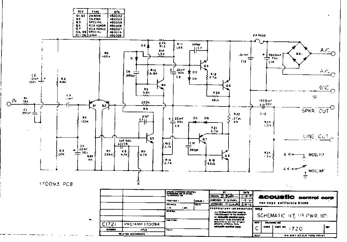

Quote from: saturated on December 12, 2024, 05:48:54 PMIdk if this is gonna be useful for anything
Old guard power supplies, not much use today.
*Guess* +/-5V was for old style Logic boards (where 5V supply was the standard) and +48V is standard for classic *telephone* lines.
The whole bunch might have powered some kind of telephone central, maybe in a small neighborhood or large Factory central.
Analog regulated supplies were very inefficient, hence the need for heatsinking and fan cooling; today any old computer supply can offer 5 Volts at 20-30-40 Amps for peanuts.
QuoteI'm gonna try the plus and minus 5v on my Op-Amps  xP
Way too low for that, they will work but poorly.
QuoteIt would be cool 😎 to find a good use for it it's built like a tank.  I just don't have an immediate need for 49v DC.
I need to figure out why when I measured across the filter cap I got 78v.   :loco
+78V is raw unregulated voltage, then down regulated to very clean 48V
perfect for a 100W into 4 ohm power amplifier, single supply of course, like the Acoustic Control Corp Guitar and Bass amplifiers.
You already have the +78V supply, the rest is easy.
Driver and power transistors have modern equivalents, you would need to draw your own PCB.
Power transistors are selected/good quality 2N3055 and you already have them.
You can also use the aluminum sheet heatsinks.
You are 90% there.
You can also build any preamp you like to drive it.
+/- 5V supply can probably give you raw +14/16V if halves put in series.
Not much use for the single +5V one.
