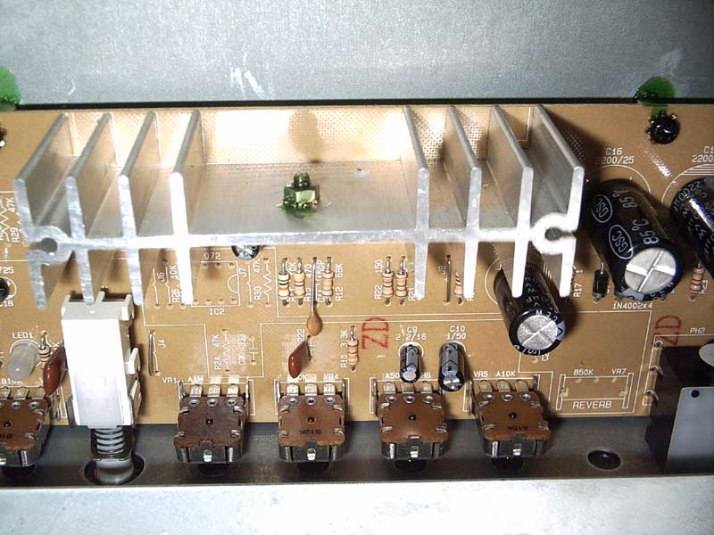

I can't get you a whole schematic other than the one on deanmarkley.com, but I can (hopefully) help you out correcting anything wrong on it by looking at my amp.

no problem ,the most important values to check is C12,C24.
C2 AND R4 also if you can locate em.
and how much voltage does the transformer outputs

the values i want to know are :
C12
C24
C2
R4
R10
R13
AND THE TRANSFORMER OUTPUT VOLTAGE

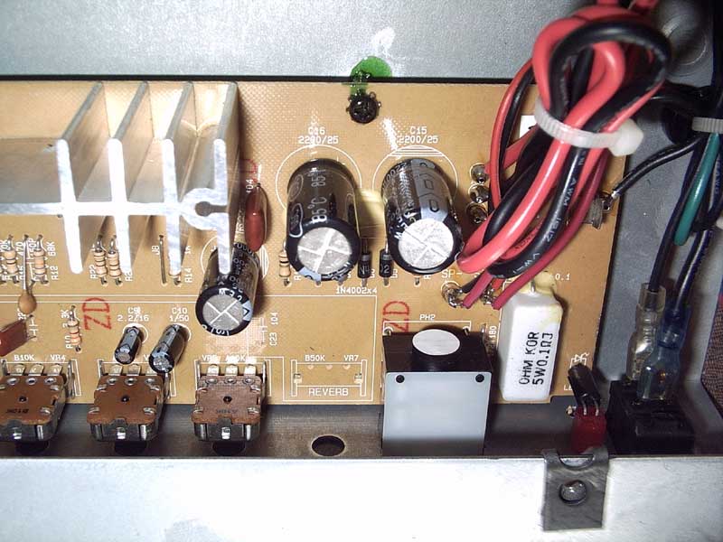

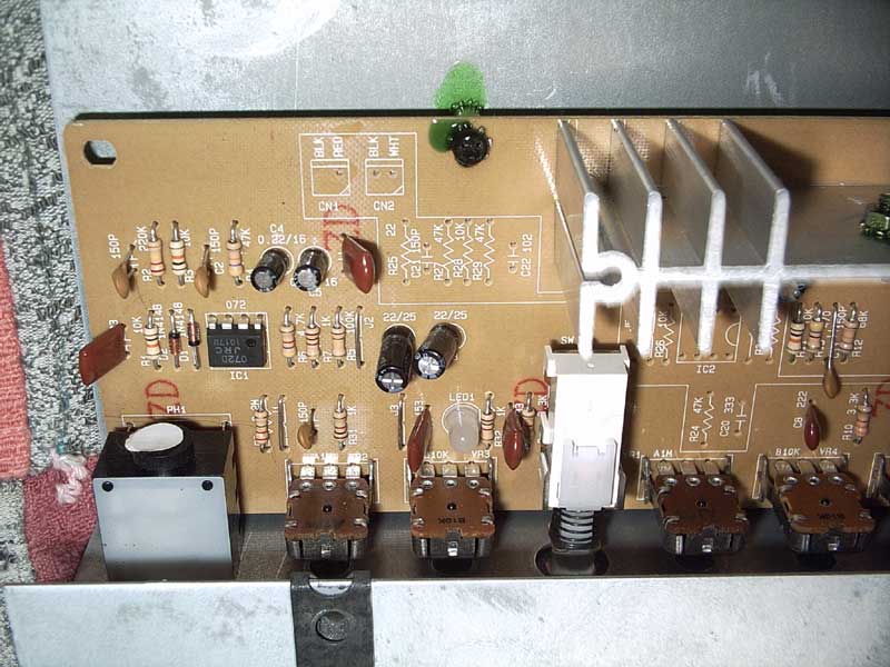

C12 - 1uF/50v
C24 - 1000uF/25v
C2 - 150p
R4 - 47k
R10 - 3.3k
R13 - 68k
Transformer voltage = 13.94v + 13.94v (running on 122.8v AC)
Looks like the schematic was right afterall.

Also looks like the amp over voltages the TDA2030.  It is suppose to get +/- 18v and its getting more like +/- 19.5v (13.94 x 1.4).

thanks man, realy awesome shots
i just wonder how an amp would sound GREAT with such freq response.,,
ill try to build this one as it is , and then change with some values n see how does this affect the sound
thanks again for openin the amp :),,owe ya

Nice photos. Seems like K-30RX and K-20X share the same PC board and chassis. Have you considered building that reverb circuit?
The K-30X is the exact same except with reverb, I noticed this about a year ago.  I thought about adding the reverb circuit into mine, but I don't know if I'll bother.  I don't remember it being that great anyway.
