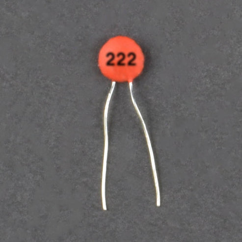

EDIT: another writing convention, to save space in small caps:
2n2 = 2200 pF is also written as:
222
which is read as
two , two, two zeros = 2 2 00
definitely compact and easy to read.
Some add extra data:
They added Voltage (1 kV) and tolerance "M"=20%
We common folks normally find K (10%) and M (20%)
