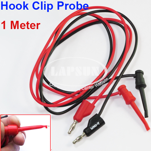

Anyone suggest some good ways to put test leads on hard to access components? My multimeter leads often get wedged in between other components and I can't get the metal testing tip down against the component lead. Sometimes I've attached a solid core wire and that has worked. Can you purchase a test lead with a long shaft? I'm thinking of my SSW220 and it's output transistors. I want to check voltages on it's pins but can't get me test leads to reach as they're just isn't room.
I find these small single hook clips very irritating because they don't get a good grip on the lead under test and keep slipping off.
These double (and sometimes triple) "gripper" probes are far superior;
Much longer, flexible, and a much more secure grip.
Hawk
Where I would buy them;
http://www.altronics.com.au/p/p0409-parrot-style-test-hook-probes/
It would seem that "parrot" is a bit of a keyword for these (and if you have ever been bitten by a parrot you will understand why).
I have both types kicking around because, like all tools, each has its strengths and weaknesses.

Both those test leads definitely have their strengths and weaknesses. I have had numerous sets of the hook type ones and they always fell apart on me after months of use. I like how they could fit in tight spaces but they were sometimes not long enough. Then I got the longer double gripper probes and they were way better. I have retired those too as they now measure about 4-7ohms of resistance for some reason. At first I thought it was my extender leads that connect the DMM to the probes, but those were fine. I then measured across each gripper probe and both of them have the exact same resistance problem. Perhaps some quality control problem in China while making those probes? Oh well now I have picked up a nice pair of Fluke AC280 Sure Grip probes and I they are way more durable/reliable. However, I am still looking for some smaller probes that won't fall apart or become a resistor.
