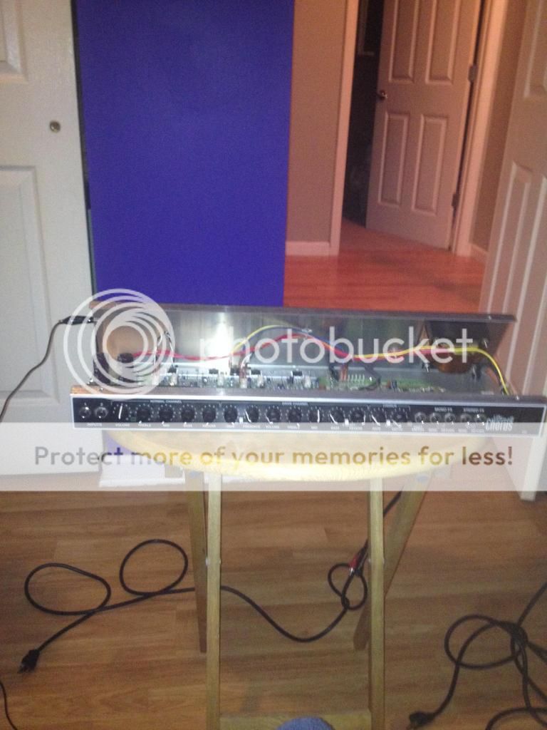

I have the discharge tool made.  It measures 970 Ohms resistance.   Also temporarily soldered one of those alligator clip leads to the black lead on my Multimeter.  Now I can ground it on chassis and probe one handed...right handed...lol.
Going to pull the chassis after dinner.
Am I missing anything?  I'm not plugging it in and doing any testing live till I get schooled by you guys on what to do. Just checking caps for voltage and discharging and inspection all unplugged.

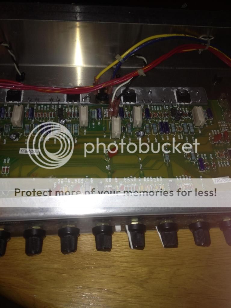

So the next obvious move is to take the board off the chassis to inspect the back of it.   Looks like I have to take all the knobs off and the heat sink deal screws from under the chassis.  And slip board back and flip it over.

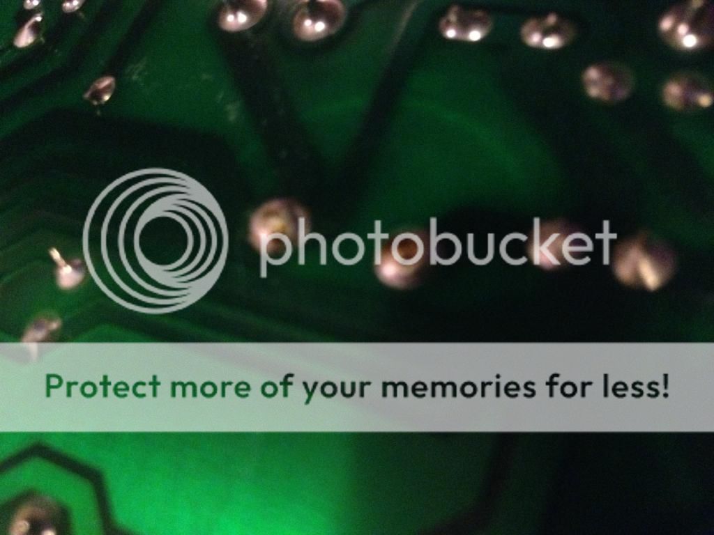

I was pretty excited.   So it was a solder joint on the filter cap.  Only one on board that looked funny.  Like fractured around the perimeter. Could barely see it.  There was no voltage higher than .2 v   So I went ahead and re-soldered all the 4 joints on the 2 filter caps.  I cleaned the pots while I was at it and the input jacks.  Put it back together...said a prayer.  Bam.  Flipped the switch and was rewarded by the amp gods.
I got sooo lucky...cause I don't know a damn thing about electronics...lol.
Bad joint
Fixed

Nice Job!!  :dbtu: Those loose/cracked solder joints on the filter caps can cause all sorts of strange symptoms in the amp. Shhhhhhhh.... Juan that Yamaha was a surprise "Secret" gift...
