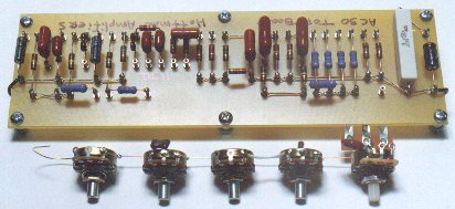

Hi all,
Yet another circuit for you to play with. ;D
This is the first part of what is basically an elcheapo Guytron GT100 inspired concept.
For those that don't understand this idea, it's basically a dual Amp setup where the first Valve  Amplifier is driving a load (Not a speaker) and the signal is tapped off and Re-Amplified via a Second Main Amp.
This gives *ABsolute Loudness Control* no matter how hard the first amp is driven.
You now have the ability to dial the Valve rig to the sweet spot and not have to ever worry about playing too loud.
This lifts the dreaded restriction of setting SPL levels in smaller venues or just playing at home. You can now play full up without annoying the folks next door.  A great asset for practicing those fast high gain licks.
The Guytron is a *2 Valve Amps in one Box trick* which would be fantastic but the cost is a little scary for the average player.  I've gone down the *Modular path* which allows me to swap things around if need be and because I'm using cheap S/hand bits I've kept my costs to a bare minimum.
The floor pedal is a mix of Mesa Vtwin ideas and my HiWatt inspired PhAbbTone. Sadly the Vtwin like most valve powered preamps tries to do the OD/Distortion all in the preamp stages but anyone who understands valve teck well would know that **Triodes can't do square wave like Pentodes** and although these circuits can produce copious amounts of crunch/ distortion they tend to lack the richness of a pair of output pentodes driving through a transformer.
*Pentodes where actually invented to overcome the sevre shortcomings of triodes,, hum.*
One wonders at the wisdom of rows of fizz bottle triodes??? :loco
As will be obvious to those who know the Vtwin circuit, I've only used the *Clean section* as the crunch channel is basically useless for the sound I wanted and was just wasting space.
**The main Valve Amp does the magic endless sustain and touch dynamic ODrive**
So don't build this floor unit thinking it will be a monster crunch pedal as this produces a very clean signal but with greater voltage swing than an all SS unit.
Although it does do a very nice rock (half wave) triode rattle when driven hard on the Clean channel. <3)
If you desire the *Mid scooped Metal sounds* you will need a Graphic in the final Loop before main SS power Amp and most will want a bigger main Amp and speaker setup as small amps struggle with low freq.
For the small gigs I do this little Laney is just so damn convenient.
A quick post of the first schematic section.
(I will Update this if there is some interest and give more details of the finer points of building such a rig.).
Enjoy, Phil J A.

Here's a pic of the Floor unit, Note that no expense was spared in making it look home made? Heck at least no one will steal it unless they first knew it's worth. :)
Also note the SMPU is still mounted on testing board.
