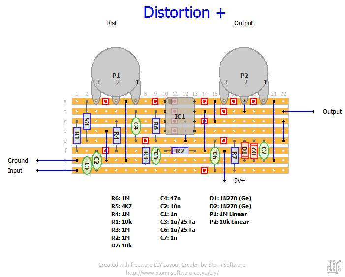

In these cases, to start withy something I suggest building an MXR Dist+  distortion pedal and use it as a basic preamp, it has no tone controls but excellent gain and volume controls and can straight drive the TDA2003 .
You can get all sounds from clean (Dist. set to 0) to quite distorted.
FWIW it was the *classic* distortion sound of the 80's British Heavy Metal, go figure,think Judas Priest, Iron Maiden, etc.
Not bad at all;)
And it's designed for 9V batteries, works like a charm fed from the TDA2003 12/16V supply.
So you can make a nice metal machine, 2 knobs, compact and portable, driving a couple 6" speakers and have up to 12W ... a *very*  usable amp.
Not bad for a first project, huh?   :dbtu:
for a stripboard layout:
http://i181.photobucket.com/albums/x108/kalamaca/distortion.gif~original
