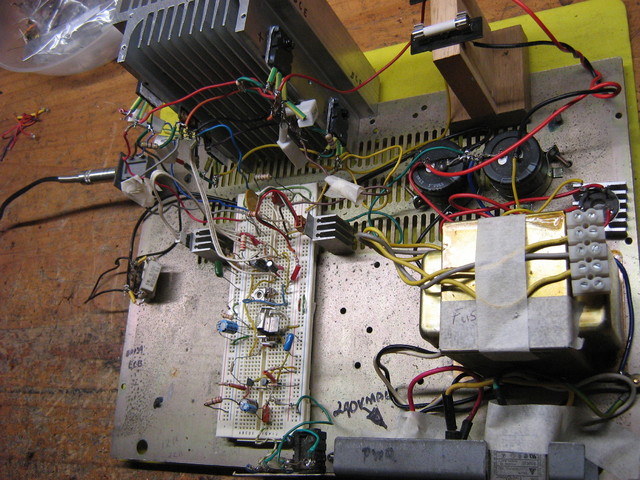

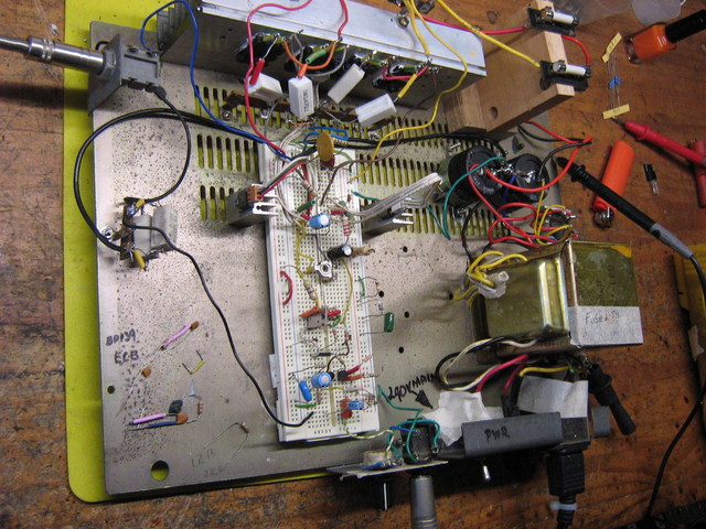

The Laney rebuild I'm posting for you to show the BBoard testing setup of a power amp
It's very basic and likely not an ideal bench test setup but well worth the effort.
As you can see in the pics the laney only had a small Tx and when using the Keyboards the supply could not keep up. I rebuilt the entire PSU and power amp section. The 3 Ch preamp section is basic but functional. (Hey it does have a Tank Reverb which is nice)
You can see in the pic the difference from the original back panel and the rebuild.
I've added the Schematic for you as that may help to understand the pictures.
This uses over rated devices as I've found with my basic rule of thumb knowledge. :P
As long as the transistors are way above what is needed then less chance of failure.
(i.e the 2SC5200 is a 250V-15A-150W device) They are the 3 main things to look out for.
As explained in Art of Electronics the whole idea of these DC coupled amp designs is to keep the DC Q point of *Output & the bases of Q1,Q2 at close to Zero as possible*,as I've noted on my Schem.
The Voltage and Temp measurements were taken from test circuit not a simulation.
Current limit is done with a trick little device on the output,a PTC (Poly Thermal Capacitor or just PolyFuse)
Hifi geeks might not like them but saves all the extra PCB space.
Short circuit testing was done with amp at full power on the test circuit pictured about 20 times for at least 10 Seconds.
The Poly Fuse will trip at ~110Watts, The colour will darken when they get close to trip.
Absolutely brilliant little device. :dbtu: :dbtu: :dbtu: :dbtu:
Pleae note;; This was 5 Years back I may have slightly changed something since then,, but it's all very close to how it was built.

Oppsy forgot the Test board pic. :-[
Probably not the ideal test setup but when on a budget one has to be inventive.
Most of this is recycled El stuff I've collected over time.
As I've done a few times, I did again test to see if Current FB was worth the fuss but just did not hear any magic so gave it a mis. It's those two 5watt Resistors on the side, near the Grey output jack.
Not in picture but I used a light bulb limiter for every new tweak,, It saved me a couple of times during this experiment.  ;)
