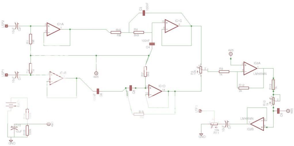

Here's the schematic. It's basically two unity gain Sallen-Key filters, a highpass for the bridge and lowpass for the neck. I will admit, the concept is not mine. The guy who will be using it asked how to do it and I ended up making it.
I found that using one pot for blending works better than a dual. Perhaps I should have buffered Vref, since the opamp inputs sit a bit below 4.5V.
Personally I prefer discrete. I find it easier to work with. At small signal level, emitter/source degeneration suffices for biasing. This is supposed to be a more 'hi-fi' tone, so I went with opamps. Might make a transistor version too. It'd probably come out smaller, knowing my layout skills.  xP
Also, I really need to play with Eagle more...
@EuphAural - I could easily be wrong about this, but in the process of having a look at FET-ising your circuit I've come across something that could be a more serious problem than the power switching.
As well as giving you amplitude rolloff the filter circuits also naturally produce phase shift, lead in the high pass and lag in the low pass.
When these are recombined they are +90 deg and -90 deg respectively, meaning that around the crossover they are 180 degrees out of phase, and naturally when you sum them in the pot you get a cancellation across the crossover frequency; a -30dB notch around Middle-C.  I suspect that this is not what you intended.
I've attached the LTspice model showing the effect.
Kaz Kylheku
#9
I have a couple of comments.
1.  Op-amp choice.
Do not use a 4558 op-amp, argh!  :duh It's a piece of crap that belongs in low-end audio gear from the 1980's. There is no reason to use it in new designs, even if you were making 10,000 copies of your preamp and having it all cheaply built overseas. Use NE5532 or better.
2. Ref voltage.
If you can come up with one more op-amp, you can improve on the voltage reference circuit by decoupling the generation of the reference voltage from its use. Take the output of your VREF voltage divider and put it through an op-amp buffer, the use the output of the buffer as the reference voltage everywhere else.
3. Too much buffering
Turns out, you don't need another dual op-amp chip to get an op-amp for the ref voltage. You can simply take one out of the existing circuit! See, you have too much buffering.  After your virtual earth mixer, you do not need to buffer the signal one more time. It's pointless. I think you're only doing it to decouple the volume attenuator from whatever circuitry follows.   But you can get active volume control by putting a pot in the feedback of the inverting mixer (configured as a rheostat). That nicely goes from zero to whatever gain you want.

A couple comments:
1) that notch might not be a bad thing after all, we are not playing back recorded music but it's part of an  musical instrument.
Anyway, it won't happen, because each active filter is fed audio from a separate pickup, so ....
2) The RC4558 is not bad at all, and in fact it's still way too much for what it's asked to do here, with such a low gain per stage.
And NE5534 *is* excellent, no doubt, but as I said, no difference will be noticed *here* ... but the twice as much (or more) current guzzling will definitely be.
In fact, a popular choice in active instruments is lower performance TL062 ... because it "eats" 1/5 of what a TL072/RC4558 does.
In fact low power consumption  is such an important parameter, that the respected Music Man Bass uses an abysmal performance LM4250 ... because it can be programmed to "eat" almost nothing.
Battery life becomes shelf life, easily over a year (and many up to 3 or 4 years)
After all, many active electronics ask very little from the active elements.
Of course, in Hi Fi or PA stuff, consumption is not important.
Even so, I know of one case when a Tech upgraded a big Mixer to NE5532 (over 120 devices) .... and then he was short of PSU current, he had to upgrade it too.
Nothing is free  :(
EuphAural
The opamps are TL074 and TL072. I don't know why I picked a 4558 there. Like I said, need to work on Eagle.  :lmao:
Buffering the Vref is something that needs to be done. I was thinking a small regulator might work, but that would take up more space. Freeing up the other opamp would help. My intention there was to isolate the tone section from the volume, but realistically that doesn't matter much.
The phase shift may be an issue. I found flipping the wire on one pickup improved the blending a bit. Should just make one input stage inverting. Possibly the LP side, since I might need to tone down the gain on it a bit.

Quote from: J M Fahey
Which are sensing the same string(s), hence...
Quote from: EuphAural
I also found that connecting one input anti-phase eliminates the notch.
Since five out of six of the op-amps are actually 100% NFB voltage followers, using a low noise device seems a bit moot.  The critical factor here would seem to be power consumption.
Yep, that Don Tillman "active cable" is a great, simple, idea.
#14
QuoteQuote from: J M Fahey
Quote from: Roly
Well, that's precisely the point !!!!!
If you invert phase on any of them to cancel a small notch ... you end up adding signal from 2 pickups ... out of phase!!!
Talk about cancellation !!!
