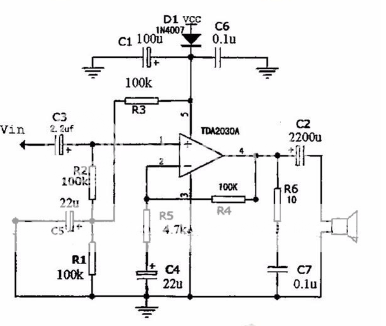

Now to preface I am completely new to amp building but have been around the pedal thing for a while.  Starting to try and piece an amp design together in my head and think I've settled on a TDA2030A power amp.  Initially thinking I'll build the power amp all +18V DC as I understand how V+ to GND works from my pedals, so the schematics make more sense.
Here is the schematic I am looking to use.  It's the generic single supply one from the datasheet:
For the voltage I am looking to run it at +18V DC since the preamp I am looking to build will run at +18V DC. Now I know I could just get an +18V wall wart but I thought I'd try and get my head around being able to build the amp so I can just plug 240V into it (Australian) and have the amp convert to +18V DC.  Now I know nothing about how this works but from looking at schematics, is something like this what I need:

Make sure you have TDA2030 available, those are obsolete and getting hard to source.  TDA2040 or 2050 would also work.  LM1875 is the same idea.  A few more pins, but the LM3886 is common.
I suggest you build this with a wall wart, and then read up on mains based power supplies.  Transformers only work on AC, so your 18v AC from the transformer needs to feed into a power supply circuit - exactly as inside a wall wart.  The circuit is not complex, a bridge rectifier and some filter caps.  But necessary.  On the 240v side, you need to be aware that the 240vAC main are lethal and can kill you.  Not a trivial concern.  You would need a power cord, a fuse holder with appropriate size fuse, a power switch.
SUpply voltage is not critical, so 18v, 20v, 17v, whatever.
Power supplies are not complex at this level, you don't need regulated voltages.  You can always go back and build a power supply into the unit and remove the wall wart.

Thanks ENZO really appreaciate the advice.  With all that in mind and reading the AC voltage thread I think it might be safer for me to just build the amp with an 18V DC wall wart and get that bit right first.  I'm careful but the risks are certainly higher any other way.  Seems I can get hold of all the amplifier ICs you mention so I'll have a flick through those.  Sounds like the 2040, 2050 and 1875 are more 'current' choices, which I can find easily it appears.

Just wanted to update.  I have gone away and done a good session of learning about transformers, rectifiers and power regulators and I think I'll be able to to build this now if I buy the correct transformer.  I am acutely aware that 240v is lethal, so I have taken all that into consideration.
Rectifier and smoothing caps aside (have that mentally sorted), to run 18v DC well, I will require an 18v voltage regulator, which I'm pretty confident is this one:
https://www.taydaelectronics.com/catalogsearch/result/?q=lm7818
and a transformer that puts out a slightly higher voltage than I want to regulate, such as 240v primary with 21v or 24v seconday?
Just want to confirm I'm on the right track?

Yes just take time to absorb what is happening,,that vid only scrapes the top there is still some gotcha's you need to know. Rectification comes in many forms and each one has different abilities.

Normally you won't need a regulator for the power amp section but they come in handy for preamp circuits where you often have to drop down the voltage from the higher Voltage rails that power the main amp.
That sheet is wrong, where did you get it from?
We do NOT use rectified resistive loads so it´s irrelevant and confusing.
Nor choke input supplies, which went away with the Dodo, decades ago.
And average voltages are wrong; if anything real world voltages are=  peak rectified minus ripple (which depends on capacitance, frequency and crrent consumption) minus drop in transformer winding.
Please hide it because although it does have some grains of truth,they are mixed with errors, which a beginner can´t tell appart.
