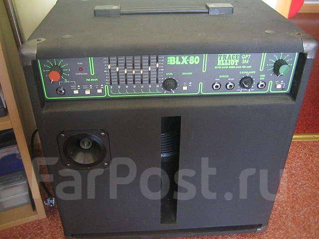

Trace Elliott once made a weird Bass amp, 10" woofer, 80W SS amp which delivered as much wall shaking bass as any 15" or 18" equipped combo ... only problem is that's all it provided, ZERO mids and highs, so much so that it was impressive in your bedroom, but absolutely disappeared (except as mushy rumble) besides any guitar amp or drummer.
Some inventive Russian player added a tweeter, but it's not enough.
The *deep*  cabinet is divided in 2 chambers, the front one tuned by the vertical slot, the rear one tuned by the wide narrow bottom one.
Notice that you do not listen to the speaker itself but to the slots.
