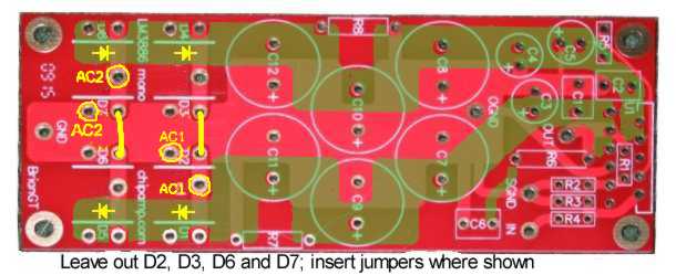

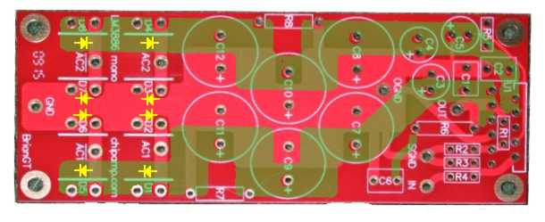

Quote from: joecool85 on August 29, 2009, 08:51:54 PM
Pic 3 (this is the board I've been working with, and it came stuffed by Brian himself, so I'm assuming it was done correctly)
"Correctly" is not clear. That depends on intent.  :)
I've done some photo-retouching on the pics. The result is here:
This is a top-side image with the bottom traces imposed in transparent green. Eight diodes means two bridge rectifiers. The board is set up to take either two identical transformers, a two-secondary single transformer, or a single transformer with a CT.
I think.  :)
First how to hook up your power supply. Solder the CT in that Ground hole. Solder one of your secondary wires in AC1 and the other in AC2. Either AC1 will do, as will either AC2.
In fact, there are twice as many (expensive, by the look of them) diodes on that board as are needed. You can remove four of them and just use the pads for the places where you left the diodes. For a bipolar supply, you never need to do two entire bridge rectifiers, as you can always connect up the transformers in a Full Wave Center Tap connection.
Some observations on the board:
- twice as many diodes as needed
- vastly bigger diodes than are needed, even if they're supposed to be fast/soft recovery diodes
- very, almost overly generous board layout
If this not intended to power other LM3886-only board with this power supply, it's both bigger and more expensive than it needs to be. I'm guessing that whomever laid this out is not a pro. Not that that's necessarily a problem. It'll probably work fine when put together and hooked up correctly.
Which brings to mind that the instruction sheets for this build need some updating.  :)

Quote from: joecool85 on August 29, 2009, 06:31:11 PM
... the board has two holes labeled AC1 and two holes labeled AC2.  It also has a hole labeled GND.  I have 3 wires coming off my tranny, two hots and one neutral.  I split the neutral so that it went to one of the AC1 holes and one of the AC2 holes and then sent one hot wire to each of the other AC1 and AC2 holes - I didn't hook anything to GND.  All I get is a blown 1amp fuse.  So I replace the fuse with a 2amp, because thats what you normally use with an LM3886 anyway, and the tranny gets hot, the diodes get hot and the tranny hums.  And its not rectifying to DC either.
What am I doing wrong here?  Do I need to jumper some other wires and send the neutral to GND on the board?
You need to get out your ohmmeter and/or the schematic/layout of the PCB.
Mother Nature is telling you that the PCB is not what you think it is. Not knowing that PCB, I would guess that two terminals of the four in AC1 and AC2 connect to each other, and two others go from the pad on the board directly to opposite AC input sides of a bridge rectifier.
If you have a transformer with a CT, then hook the CT to either one of the two holes from AC1 and AC2 that the PCB has shorted together. Hook the non-CT wires to the other non-shorted holes in AC1 and AC2.
To save on environmentally sensitive fuses, make yourself a light bulb limiter. I *know* I've mentioned that to you before... 8-)
