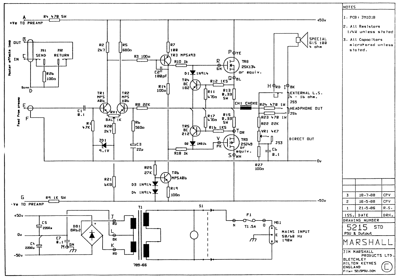

I guess I never really detailed what exactly I was planning to do. Here's the schematic:
On the pcb, the negative side of the speaker wires and external speaker jack go through the headphone Jack, then there's one trace from the headphone jack that connects to the ground fill of the pcb. I cut the one trace and attached a 0.20 ohm 10W resistor from the sleeve tab of the headphone jack to ground. Originally planned on using a 0.22, but mouser was out of them.
From the connection of the 0.20 resistor and the headphone jack, I attached a 100uF cap, ran in series with a 220 ohm resistor, and wired that to the junction of R6 and R8. I changed R6 to 1k ohms. The 220 ohm resistor was originally a 330, but I replaced it with the lower value after a play test.
I will say the difference was not dramatic. The lows are definitely deeper, the highs were a bit more open. In addition to the power amp mod, I changed a couple values in the preamp to boost the treble and enhance the presence of the amp. Now it sounds quite to my liking.

So, I went ahead and did the mod. It worked pretty well, and there aren't any stability issues. Thanks for letting me bounce these ideas off of you folks.

Quote from: Loudthud on April 07, 2023, 09:06:32 PMThe big problem with the Marshall MOSFET design is that it will burn up those Hitachi FETs with little provocation. It really needs two or three pairs to be reliable. I'm not sure what it looks like inside but adding more FETs to the output could be difficult. You may be able to find some heavy duty replacements, but make sure they have SOURCE tied to the case of the TO-3. Most big FETs are TO-247 these days so you may have to improvise a heatsink.
The first thing to do to add the mixed mode feedback is to isolate the ground of the speaker and the external speaker jack.
Ok, so I'm not totally off base about the design seeming to push the transistors too hard? I could order a pair of 250W Exicons; there are still new ones available for the moment, though it looks like there may be only a few hundred out in the wild.
I haven't opened up the 5215 yet to inspect the power amp pcb. I figure the the jacks are the plastic Cliff style, so it may not be too hard to isolate the speaker jack from ground. The pcb might not be so accommodating, though. Next weekend I'll be able to take a closer look.

Let's forget all about the current feedback issue, and just talk about the stock power amp for a moment. I told myself going into this that if I could figure out the parameters of the stock amp, then I could figure out how to make the mods so the amp stayed within those parameters. While analyzing this design, I found that there's really nothing to stop the user from destroying it. The preamp can supply 1.7V peak before clipping, by my figuring. But I'm also figuring that it only takes 755mV to drive the amp to the point that the current protection starts clamping down. At that point the amp is putting out 231 watts at peak.
Since I'm not experienced designing SS power amps, I'm left wondering if my analysis is wildly incorrect, and with a lot of questions about the stock 5215 design and SS amps in general. Why does the preamp appear to be so mismatched to the sensitivity of the power amp? Why wasn't the amp designed with lower voltage rails, so it would clip before reaching that amount of power? Why is the current protection set to clamp so high? Is the amp actually capable of safely providing much more output than the rated 100W into 4 ohms? How do I figure out how hard I can drive the amp before it burns out? What am I missing that makes this design make sense?
I know this is a lot, but any info you have to share is appreciated. I also plan to read Teemuk's book. I haven't found the answers in it yet, but I have only had a chance to skim it. It looks like a great resource. Thanks again.

Greetings! This is my first post here, and I have a lot of questions about the possibility of modding my Marshall Mosfet 100 Reverb 5215. I tried searching for threads that touch on the relevant topics, but I didn't see much that answered my questions. I apologize if these topics have been discussed and I missed the info.
Basically, I'm thinking of modding my 5215 to add current feedback, in the hope that it will add some depth and presence to the tone. In its stock form, it sounds a bit dry, and dull on top. Here is the schematic of the power amp. I have experience with vacuum tube electronics, but less with solid state, outside of preamps and pedals.
Going into this, my main concern is that replacing some of the voltage feedback with current feedback will give the amp more gain at the extremes of the speaker's impedance curve, and that this might cause clipping with higher signals. I don't have enough experience with SS power amps to know if clipping is safe within the safe operating area of the MOSFETs. Is this a valid concern?
While researching that, I did some math on the stock power amp. It appears that it only takes 591mV peak signal to drive the power amp to full 100WRMS output into a 4 ohm load. The preamp should be able to put out almost 3x as much peak signal. Is this common? On top of that, it appears the current protection doesn't start to work until the amp is putting out 7.6A of current, which is way past the rated power of the amp into a 4 ohm load. Is this normal? Is the protection only for shorts?
It looks to me, in my limited knowledge, like the amp is already built to melt itself down if the user is just a bit too exuberant. Would using current feedback only make it more likely to be pushed beyond its limits? Can I beef up the protection circuitry to make it safer?
Thanks for reading, and thanks ahead of time for any insights.
