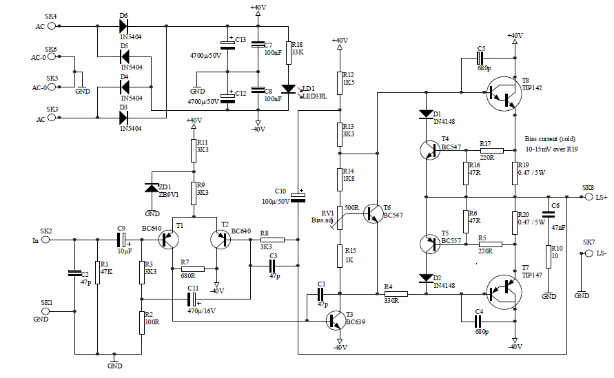

I was recently given an interesting power amplifier PCB based around a Darlington TIP41/TIP147.
I haven't built it yet, but since its a pretty simple circuit, I wanted to see if anyone had any suggestions for how I could make it work well as a guitar power amp?
Ideally, I'd like to experiment with making a hybrid amp.
You cannot view this attachment.
Would this be an opportunity to add current feedback from the speaker?
Could any of the component values be changed to help the response?
Or is it fine the way it is and I should just focus on the preamp?
Thanks!

Definitely not HiFi, but this amp if I remember rightly was originally used as a guitar amplifier. It will not produce anything like 150w not with those transistors, but should get close to half that. i cant remember who the designer was at the moment.
Use it as is, crude but does its job.
Later you can build a better one but it´s fine for experimenting.
It´s somewhat on the edge, use +/-40V rails or so (30+30VAC PT, 2,5A), 8 ohm load, beware it has NO short protection.
No big deal in a Combo or powered cabinet, somewhat dangerous on heads because someday you WILL meet a bad cable.
Power output is similar to a Bandit, VS8080, Crate or Laney 60, etc. , enough for playing around with a good speaker, say an Eminence or Celestion or modern Jensen
Not HiFi, Car, Home Theater class speakers.
Use good heatsinks.

I did actually want to build this as a stand alone head, so I think I should add in some kind of protection circuit.

You are lucky: exactly that same basic amp but properly made (not much more added, yet ...)is offered in kit form with an *excellent* 20 page assembly manual.
Enter the Velleman k8060.
Proper biasing, short protection, very flat assembly (board,  supply,  power transistors at the ends) make it easy to mount inside a Guitar amp chassis or a powered speaker back aluminum plate.
Circuit:  (eerily similar to the crude one):
Full  manual :  https://cdn.velleman.eu/downloads/0/illustrated/illustrated_assembly_manual_k8060.pdf
from:  https://www.velleman.eu/products/view/?id=360242
They even offer a heatsink, custom drilled or not, and a suitable power transformer.
Of course you can buy only the PCB and parts kit and mount it on your own heatsink or aluminum chassis and get a cheaper and maybe closer to home ANTEK toroid.
Anything from 26+26 to 30+30 VAC, 2.5 or 3A will do fine.
Amp marketing is "optimistic" as usual, forget the meaningless "200W peak power", it has honest 70-80W RMS into 8 ohms, which is perfect for live use.

A few words about the need for short circuit protection. In addition to the bad speaker cable as mentioned by J M Fahey above, there is the very real possibility of a momentary short occurring when using Switchcraft brand jacks (or similar) on the speaker cabinet. Cliff type jacks don't have this problem.
Most Guitar amps use Phone plugs to connect speakers. When a cable with Phone plugs is inserted into a Switchcraft jack, a momentary short occurs across the cable. If an amp is Powered On and you first plug the cable into the amp, no problem yet, until you plug the cable into the speaker cabinet. The amp sees the momentary short and could blow up. Best to leave the amp off while you connect the speakers or always plug into the cabinet first, then the amp.
Those 60s solid state Thomas-Vox amps didn't have short circuit protection. How did they get away with that ? First, they used XLR type connectors for speaker connections. Those won't short the signal. Second, they used an Off - Standby - Play power switch that didn't connect the amp to the speaker until you were in the Play mode. Pretty clever :)

I think that PCB is not well designed, you will need a good heatsink on the power transistors but the transistors are right in the middle of the PCB, right behind the transistors where you should mount the heatsink bracket are 2 small footprints for 7 watt resistors.
Have I been asleep for centuries and 7 watt resistors have now shrunk right down in size ?
I would throw that PCB in the bin, I would never try to build that amp since it will undoubtedly lead to heartache.
You can buy a 100 watt class D amp for less then the cost of the components you need to complete it, and the transformer will be expensive as well. There are so many better and cheaper options out there.

Now the "150W Darlington Amp" looks like it was hastily thrown together.
It may meet the "electrical" connections but layout is ludicrous, the thing is unbuildable; so much so that they show a *simulation* where to boot Power Transistors are NOT inserted  :duh
Because they can´t.
Bonus points:
* as noted above, real 7W resistors will NOT fit there, no way.
* speaker ground return track is impossibly thin, it will explode on the first drum roll or something.
Funny notice: LM 3886 board has the "Use heat sink" warning printed on the silkscreen side ; "150W" one does not even mention them.  :lmao:
That said, IF you already bought it and have no option, it *may* be built, sort of (assuming design is fine, of which I am not sure) by mounting TIPs on a heatsink proper, and running wires to PCB holes.
Same with 7W resistors.
But why bother to correct a botched board design which to boot is also poor electrically?
If you want the hands on build challenge, fine with me, just get the Velleman board, either as a kit or on its own, use your own heatsink and transformer.
