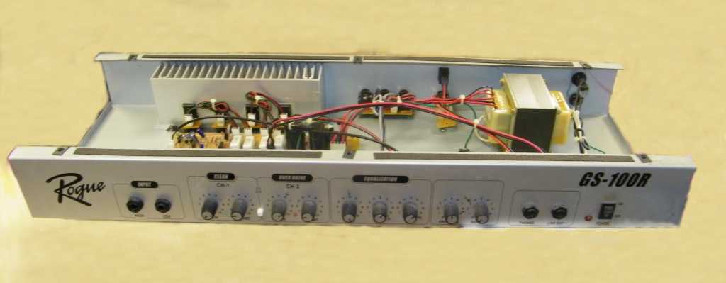

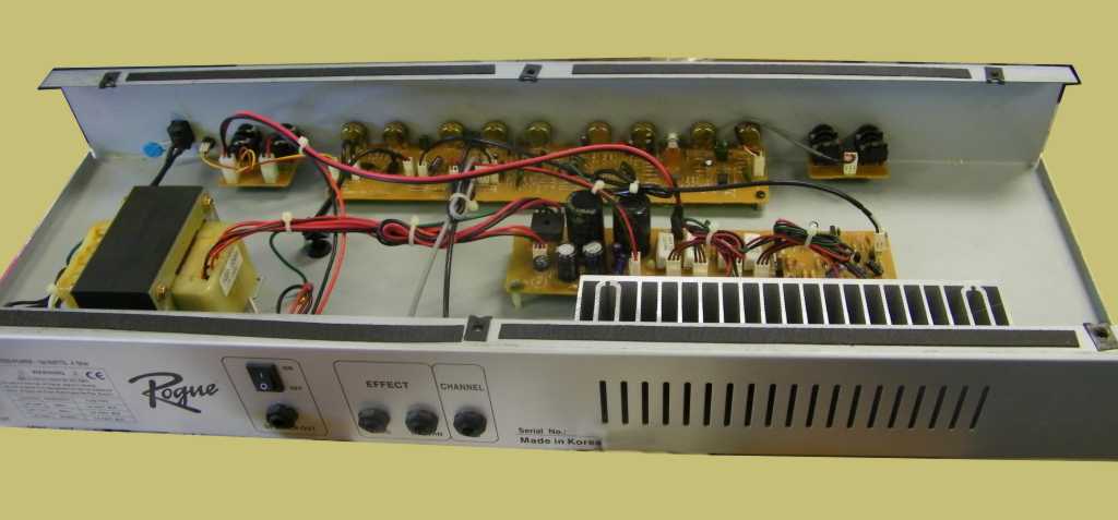

I did take a couple of photos.
Front view:
Back view:
I think Dr. Frankenstein would have been proud of his assistant for digging up this one.  ;D

Wow, that's a lot of room inside it. I like how it's mostly "modular", so you can e.g. save the power amp board and just refit your own preamp - or something along those lines. There's also room to stack boards on top of each other if neccessary.
Edit: Am I looking at it correctly; are all of those power transistors contained on their own little boards? Wow, that's something I've never seen before.

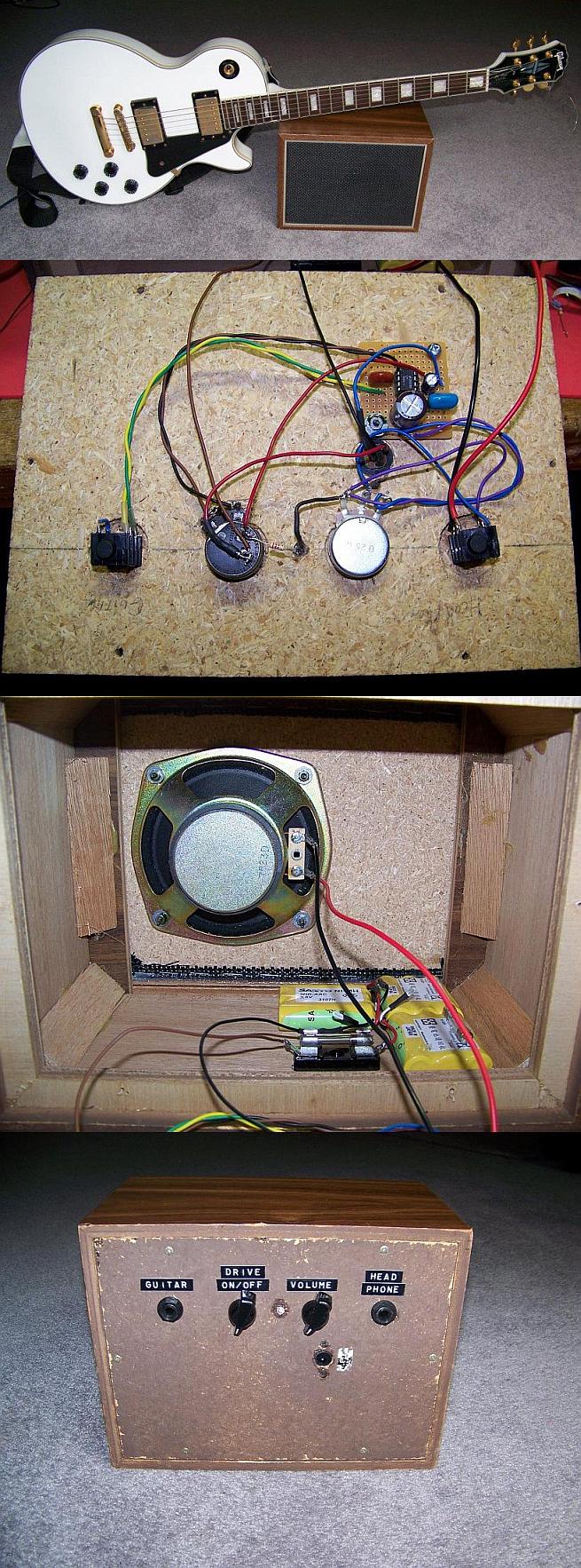

I've attached a picture of my first (and so far only) attempt to build a cabinet from scratch for comparison :)
teemuk
That's a way better looking cabinet than anything I've ever built. I wish I had jigs and tools to make those finger joints. So far I have only managed to make butt joints reinforced with dowels and screws.

Quote from: teemuk on August 28, 2009, 01:35:44 PM
Yep, you're seeing it correctly. Actually, that's one of the problems with this amp. Since I now own it, I did some checking on the reputation. They seem to inspire only two reactions - "good value for what I use it for" and "... cheap, nasty sounding junk".
I think both of those are correct. The entire amp is interconnected on those little white plastic connectors so the boards can be connected with stick-in cables for fast assembly. First of all, small connectors can't carry a lot of current. The output transistors have to put out on the order of 11A peaks, and that's going over *1* of the pins in a little square-pin connector. Get some dirt on it, let it heat up and get loose, and you have a power intermittent.  Then there's what vibration do to the connections. On top of that, every single control and jack is PCB mounted - in some cases, the PCBs are also "jack-mounted". The proximate cause of mine being $40 was an intermittent input jack - and it was obviously because someone bent on a plugged-in plug hard enough to crack the plastic jack and PCB. PCB mounted jacks, pots, and switches are a Very Bad Thing in guitar amps.
I just received a couple of pairs of Toshiba power transistors to replace the marginal TIP3055/2955 pairs, and I'm going to solder the wires to them, not PCB- and plastic-connector interconnect them.
I believe the all-PCB, all-the-time construction was a manufacturing saving. You could use a break apart PCB which contained ALL of the circuitry, including traces interconnecting the various little boards, then populate, wave-solder, and test the complete board. Once a board was known-good, the boards were broken apart, screwed into place, then connected with cables. Less handling, less labor, cheaper.
I'm *glad* they did it that way - it gave me a bargain.

Teemu: I've often seen those individual miniboards in Korean amps, made by some giant OEM manufacturer, who builds for everybody including Ross,Hartke, etc. and their "house brand" is Samick.
They are used in TO220, TO218 and similar plastic cased transistors, both to keep pins firm and separated from each other, and to allow servicing by plug-in transistors.
The miniboards themselves usually have no extra components, only the connector, or at most a reverse biased clamping diode .
