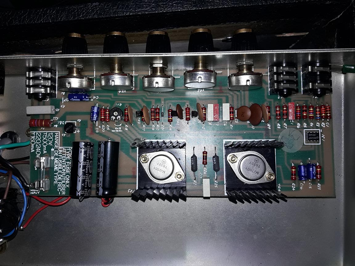

This is a Marshall 100W SS amp made between 1975 and 1978.
This comes straight from the 1973 Motorola Power Amp design handbook.
It does not use generic transistors such as 2N3055, TIPs, etc. but specific models made only by Motorola, so end user is not tempted to switch later to cheaper suppliers.
Another dirty trick (as seen on the Rickenbacker amp) was to use non standard case sizes and pinout, so repairs HAD to be done with the original Motorola stuff.
Only Marshall "guitar" mods were to add a Presence control and a tapped autotransformer so user could have 4-8-16 ohm options, both features present in Tube amps and which Guitar players expected and were used to:
These were among the earliest Marshall SS amps, they had little to zero experience with them, so they went through with a respected suplier suggestions to play it safe.
Funny thing, I am quite certain Motorola sold them A TON of transistors, or they signed a contract to buy a ton per year for "X" years, so they ended up WAY overstocked.
So they used these anywhere, including a puny 12W amplifier: 5005/Lead 12 , where it is nonsense to use a pair Metallic TO3 10 Ampere 80V 150W :duh transistors which eeasily power a 100W amp.
I bet they were SICK of having them for breakfast, lunch and dinner so they designed in inexpensive beginner amp to move them out fast.
I see no other explanation.
