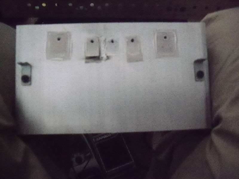

Here are some pics. Obviously I don't have this finished yet. The first pic shows the amp as it currently exists, just some components connected on a solder-less breaboard. The speaker is just some crappy 20W car stereo woofer. In the lower left corner, you can kinda see my preamp. There's obviously some stuff in the photo that has nothing to do with this project. My work area is quite cluttered. Maybe one day I'll clean it up.
The second shot is a close up of the amp on the bread board. Due to clutter, there's some non-related stuff on the breadboard. You can see the input buffer near the blue pot, which is used for biasing the MOSFET in the buffer stage. The two power MOSFET's are on a heat sink that I scavenged from an old atx power supply. The very large cap at the top of the board is just for killing power supply noise.
The third pic shows the inside of my preamp. This is the MOSFET Booster circuit that I posted about here: http://www.ssguitar.com/index.php?topic=1121.0 . It's breadboarded in my ProtoBox. I just got an aluminum enclosure and small breadboard from RadioShack. I mounted the breadboard inside, and drilled holes for various pots and jacks. When I eventually do a permanent build of this circuit, I'll use this ProtoBox for something else.
The last pic shows the front of the protobox.
I'm sure this isn't the finished product you were wanting to see. Hopefully I'll get this permanently built soon.
